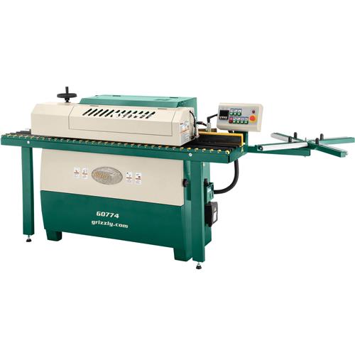

G0774 220V Automatic Edgebander
Complete edgebanding control for perfect results.
The G0774 Automatic Edgebander features individual controls for each function of the edge banding process, giving the operator complete control and ensuring perfect results!
This edgebander is made for the growing cabinet or production shop looking to upgrade its current edge banding capabilities.
Designed for the rigors of fast-paced production, it is flexible enough to handle a wide range of edge banding material (ABS, PVC, laminates, wood tape and wood strips) from 0.5–3.0mm thick on panels ranging anywhere from 1/2" to 1-3/4" thick.

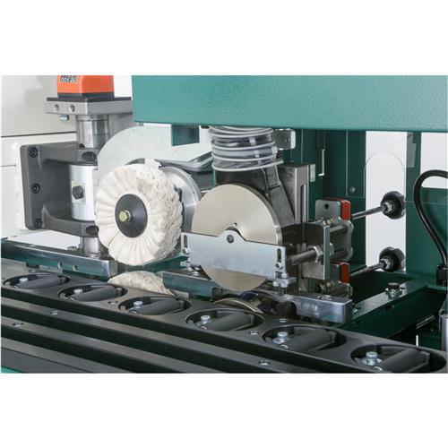

Features include automatic belt feed with industrial-duty rollers, a Teflon-coated glue pot, upper and lower trimming units with digital readout, double-bladed end-trimming saw and pneumatic banding guillotine.
  • Required power source: 220V, single-phase, min. 30A circuit
  • Feed motor: 3/4 HP
  • Glue spindle motor: 1/3 HP
  • End trim motor: 1/4 HP
  • Flush trim motor: 3/4 HP
  • Buffing motor: 1/4 HP
  • Heating element: 1535W (7A)
  • Table size: 10-1/2" W x 78-3/4" L
  • Minimum panel dimensions: 4-3/4" W x 9-1/2" L
  • Panel thickness: 1/2"–1-3/4"
  • Tape thickness: 0.5mm - 3.0mm
  • Air requirement: 6 SCFM @ 100 PSI
  • Glue pot capacity: 34 oz.
  • Edgebanding coil capacity: 31-1/2"
  • Dust collection requirement (at dust port): 700 CFM
  • Footprint: 57-3/4" x 22-3/4"
  • Overall dimensions: 109-1/2" W x 60-1/2" D x 49-1/2" H
  • Approximate shipping weight: 970 lb.
  • Automated belt feed system
  • Pull-out support arm to handle larger workpieces
  • Heated infeed fence for better glue distribution
  • Teflon-coated glue pot for easy glue changes
  • Five heating elements
  • Adjustable infeed fence
  • Upper and lower buffing wheels
  • Powder-coated finish
  • Two 4-inch dust ports
