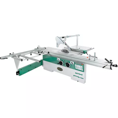

G0764Z 14" 10 HP 3-Phase Sliding Table Saw
The next level of Grizzly's industrial-sized sliding table saws.
The G0764Z 14" 10 HP 3-Phase Sliding Table Saw was engineered to handle the largest sheet goods with a sliding table over ten feet long and capable of rips over 50" wide.
Not only that–you can rip and crosscut the thickest material with a 4-1/8" maximum depth of cut at 90°.
The scoring blade pre-scores the material, minimizing tear-out for a smooth, professional finish. The material then follows through the 10" main blade for a clean, precise cut.
The large overhead blade guard is fully adjustable and includes a 4" dust port that supplements the 5" cabinet-mounted dust port.
The two flip stops on the crosscutting fence maximize production efficiency.
If you require a large sliding table saw, take a good look at this one!
The G0699 manual was written by our U.S.-based Technical Documentation Department and is packed with useful information. The complete and easy-to-read manual makes it easier to assemble and maintain your saw.
*This machine is prewired for 220V. We can rewire to 440V in a few days’ time for a fee. Please contact Grizzly Technical Support at (570) 546-9663 before placing your order.
  • Main motor: 10 HP, 220V/440V* (prewired for 220V), 3-phase, 26A/13A
  • Scoring motor: 1 HP
  • Minimum circuit size: 40A @ 220V, 20A @ 440V
  • Rip capacity: 51-1/4"
  • Crosscut capacity: 124"
  • Blade tilt: 0–45°
  • Max. depth of cut @ 90°: 4-1/8"
  • Max. depth of cut @ 45°: 2-7/8"
  • Main table size: 35-1/4" x 59-1/8"
  • Sliding table size: 14" x 126"
  • Floor-to-table height: 34-1/2"
  • Main blade size: 14"
  • Main blade arbor: 1"
  • Main blade speed: 3000, 4000, 5000 RPM
  • Scoring blade size: 4-3/4"
  • Scoring blade speed: 8000 RPM
  • Number of dust ports: 2
  • Dust port sizes: 4", 5"
  • Footprint: 74-1/2" x 35-1/2"
  • Overall size: 133" W x 202" D x 65" H
  • Approximate shipping weight: 1643 lbs.
  • Micro-adjustable rip fence
  • Independently-powered scoring blade ensures tear-out free cutting
  • Sliding table on steel ball guide system with heat-treated steel ways
  • Alloy crosscut fence for miter cutting 45° right and left
  • Miter fence has two flip stops for repetitive cutting
  • Safety limit switch for blade cover
  • Adjustable riving knife
  • 1-year limited warranty
