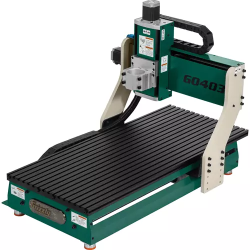

Experience the next level of precision and performance with the G0403. From its robust design to its innovative features, every detail is engineered to enhance your creative process:
  • Maximize Productivity: The 15-3/4" x 36" table is designed to balance a useful work area with efficient benchtop use, minimizing setup changes.
  • Heavy-Duty Construction: Rigid steel gantry & frame, anodized aluminum table for cleaner, consistent cuts.
  • Handheld Controller: Simplified operation with one-button tool touch-off, quick origin setting, G-code breakpoint function, file library, and 8 programmable work offsets.
  • Automatic Tool Setter: Speed up setup time and minimize the risk of tool collisions with a one-button tool setting function.
  • Ball Screw Drives: X, Y, and Z-axes with linear guides ensure smooth and accurate axis movements.
Advanced DSP-J2 Control:
The compact DSP-J2 system delivers precision and efficiency. It features a 3.5" LCD for clear data, an MPG pendant for fine adjustments, and a magnetic back for easy placement. USB and internal memory enable seamless file transfer and offline operation. Stay current with USB software updates, and minimize downtime with power-loss recovery. The G-code teach function allows direct program creation from the handheld device, making this small system highly capable. Small in size, big in capability—the DSP-J2 is built to perform.
The G0403 comes with a 65mm spindle mount ready for your personal handheld router or spindle. If being used for production use, an upgrade with the optional T34438 2 HP Water Cooled Spindle Kit is available.
To cut multi-dimensional projects like cylindrical objects, carvings around curves, and more, the optional T34439 Rotary 4th-Axis is available.
  • Required power source: 110V, single-phase, min. 15A circuit
  • X-, Y-, Z-, A-axis motors: NEMA 23, steppe, 5A
  • Axis travel: 13" x 25-9/16" x 7-1/16"
  • Rapid speed: 118 IPM
  • Supported G-code file extensions: .tap, .nc
  • Collet size: 1/16", 1/8", 1/4"
  • Collet type: ER11
  • Table dimensions: 15-3/4" x 36"
  • Footprint: 33-1/2" x 16-1/2"
  • Overall dimensions: 24" W x 36-1/2" D x 27" H
  • Approximate shipping weight: 221 lbs.
