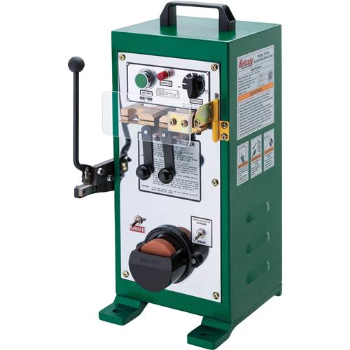

T27556 Blade Welder 4.2 KVA
Produce and mend high-quality welded bandsaw blades.
The T27556 Blade Welder can cut, weld, anneal, and grind bandsaw blades.
This allows you to make new blades from bulk coils of band stock.
Quickly rejoin a blade that has been purposely cut for making an internal contour cut.
Repair broken blades that are still sharp and useful.
Each unit features a blade shear, grinder, and welding/annealing station.
  • Required power source: 220V, 15A, 60 Hz
  • Blade widths (carbon steel): 1/8"–3/4"
  • Blade widths (bi-metal): 1/8"–5/8"
  • Blade thickness: 0.025"
  • Overall dimensions: 12" W x 12" D x 15" H
  • Approximate shipping weight: 50 lbs.
  • Convenient carrying handle for mobility
  • Spark deflector for safety
  • Adjustable clamping pressure dial
