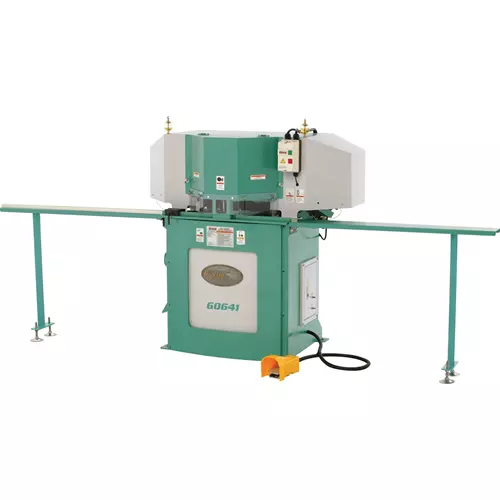

Designed for production, this Double Miter Saw simultaneously cuts two 45 degree angles for perfect 90 degree joints. The blade swing arms are micro adjustable for perfect angles and the foot pedal control activates the pneumatic hold downs and swing arms. The two side wings support long stock and the stop block can be set for cutting multiple pieces of uniform length. Two 12" blades provide plenty of cutting capacity and an adjustable stroke speed gives you plenty of cutting control.
  • Motor: 2 HP, 110V/220V (pre-wired 220V), single phase, 20/10 Amps, 60 Hz, 3450 RPM, TEFC induction
  • Table size: 32-5/8" x 4"
  • Table height: 33-7/8"
  • Extension wing size: 48" x 4-1/2" (x2)
  • Maximum cutting width: 2-3/4"
  • Maximum cutting thickness: 2-3/4"
  • Saw blade size: 12" diameter
  • Arbor size: 1"
  • Overall size: 128-3/4"W x 28-3/8"D x 57-1/2"H
  • Approximate shipping weight: 1060 lbs.
  • Micro-adjustable blade swing arm
  • Includes two 12" x 120T blades
  • Foot switch control
  • Two side support wings
  • Easily adjustable saw stop
  • Convenient cycle speed adjustment
