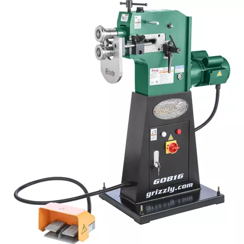

Grizzly G0816 - Heavy-Duty Bead Roller
5.0 (1)
$5,625.00
G0816 Heavy-Duty Bead Roller
Roll through heavy gauge sheet metal projects all day long.
With a maximum capacity of 12-gauge aluminum or 14-gauge mild steel, the G0816 Heavy-Duty Bead Roller helps ensure you get the right bead the first time.
Features top-mounted, one-hand height controls and an 11-1/2" throat capacity with adjustable back-plate to help you produce straight lines on a wide range of projects.
Securing each roller mandrel is a heavy-duty 30mm shaft for any of our great tooling options.
This bead roller is also remotely operated with a foot pedal, allowing you to keep rolling while supporting large workpieces, and the steel stand with oversized footprint provides an ultra-solid foundation to ensure precise, reliable results, even when rolling large, heavy pieces.
The machine comes with a 1/2" bead mandrel set. Optional mandrel sets of various sizes are available (not included).
The G0816 manual was written by our U.S.-based Technical Documentation Department and is packed with useful information. The complete and easy-to-read manual makes it easier to assemble and maintain your bead roller.
  • Motor: 1 HP, 220V, single-phase, 5A
  • Maximum thickness (mild steel): 14-gauge
  • Maximum thickness (aluminum): 12-gauge
  • Throat depth: 11-1/2"
  • Shaft diameter: 30mm
  • Footprint: 18" x 22-1/2"
  • Overall size: 22-1/2" W x 44" H x 34" D
  • Approximate shipping weight: 455 lbs.
  • Hands-free operation with foot pedal control
  • 11-1/2" throat capacity for workpieces up to 23" wide
  • 12-Gauge aluminum capacity
  • 14-Gauge mild steel capacity
  • 1/2" Bead mandrel set
  • Adjustable throat depth
  • Adjustable backplate
  • Heavy-duty steel body and stand
  • One-hand mandrel height adjustment
  • Ball oiler lubrication
  • Locking electrical cabinet
We offer U.S.-based customer service and technical support to get your questions answered and help keep your equipment running in top condition. And to ensure your satisfaction, the G0816 comes with a 1-year warranty.
