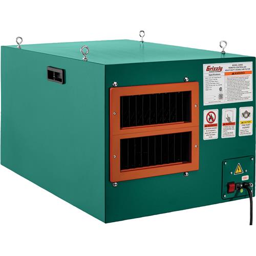

G9956 Heavy-Duty Double Air Filter with Remote Control
Capture the dust from the air in your shop.
The G9956 Heavy-Duty Double Air Filter is designed to capture dust from ambient air in a woodworking shop for a short time after cutting or sanding operations.
Set the duration and speed with the remote control from as far away as 45 feet, then hold on as the fan spools up to draw a massive 1400 CFM through the 5-micron primary filter and then through the 1-micron secondary filter.
The air is drawn in through the filters by a 9-1/2" centrifugal fan or "squirrel cage" impeller and filtered before it returns to the workspace.
The five fan speed options are 800, 900, 1000, 1100, or 1200 RPM.
The G9956 will recirculate the volume of air in a 20' x 20' x 8' room approximately 26 times in one hour. We recommend that the volume of air in your room be recirculated 6–8 times an hour.
  • Motor: 1/3 HP, 120V, single-phase, 3A
  • Maximum airflow performance: 1400 CFM
    • 1200 RPM = 1400 CFM
    • 1100 RPM = 1283 CFM
    • 1000 RPM = 1167 CFM
    • 900 RPM = 1050 CFM
    • 800 RPM = 800 CFM
  • Primary filter rating: 5-micron
  • Secondary filter rating: 1-micron
  • Overall size is 30-1/8" W x 19-7/8" D x 16-3/8" H
  • Approximate shipping weight 74 lbs.
  • Programmable remote control
  • 2-Stage filtration
