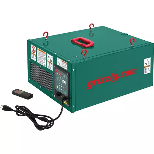

G0738 3-Speed Hanging Air Filter
This filter finishes off the job that most dust collectors only start.
Wood dust can leave your shop a mess and potentially cause nasty respiratory issues.
Turn the G0738 Hanging Air Filter on while you work and set the timer to run after you leave the shop. It will continue to clean the air of the fine particles that might otherwise find a home where you don't want them.
When used in conjunction with an efficient dust collector, the G0738 Hanging Air Filter removes most fine wood particles down to 1-micron from the air.
The remote control allows operation of the machine from any angle in your shop, even if the line of sight is obstructed.
The air filter can be set to operate in three air flow speeds—260 (LO), 362 (MED), and 409 (HI) CFM. To cycle through the available speeds, press the ON SPEED button on the control panel or remote control repeatedly. This will illuminate the corresponding lights on the control panel.
CONTROL SHOP DUST
This air filter is capable of recirculating the air in a room measuring 20' x 20' x 8' approximately 7.7 times in one hour. We recommend that the volume of air in your room be recirculated 6–9 times an hour for the best filtering effect.
The air filter can be set for a timed performance of 1, 2, or 4 hours. At the end of this time, the air filter will automatically turn OFF.
If you need a machine for a larger space, the G0572 Hanging Air Filter is capable of recirculating the air in a room measuring 25' x 25' x 8' approximately 15 times in one hour.
Like all Grizzly hanging air filters, the G0738 comes with a 1-year warranty which covers parts and assures the unit is free from factory defects.
The G0738 manual was written by our U.S. based Technical Documentation Department and is packed with useful information. The complete and easy to read manual makes it easier to assemble and maintain your filter.
The Grizzly Customer Service and Technical Support Teams are U.S. based. Parts for your machine may be available online and shipped from the Grizzly parts warehouse in Springfield, MO.
