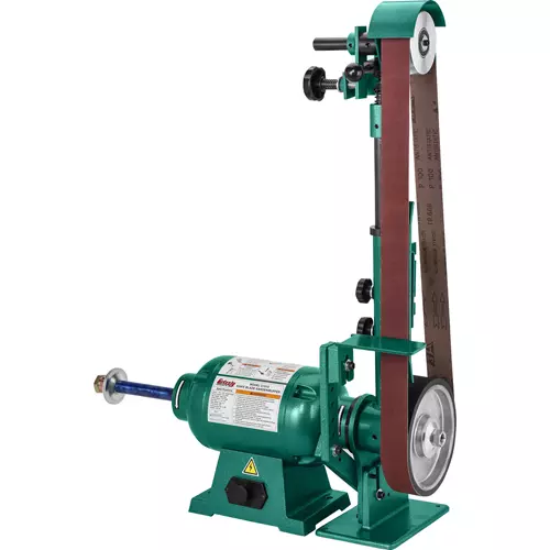

The long belt arm on the G1015 Knife Belt Grinder, Belt Sander, and Buffer is exactly what you need for grinding metal and freehand shaping. Perfect for knife makers, the 2" x 72" belt quietly runs at 3600 FPM complements of the full 1 HP motor. For a full range of replacement belts for the G1015, shop here.
The belt arm tilts from 0-90°. The belt can be changed in seconds with a quick-release mechanism. Belt tracking adjustment is as easy as rotating the adjustment knob.
Although we call this a "Knife Belt Grinder," it actually does much more than grind and sharpen knives. The G1015 has many different woodworking uses. The auxiliary arbor accepts buffing wheels, sanding drums or flap wheels up to a 10" diameter with a 5/8" bore.
The G1015 manual was written by our U.S.-based Technical Documentation Department and is packed with useful information. The complete and easy-to-read manual makes it easier to assemble and maintain your machine.
- Motor: 1 HP, 110V, single-phase, 14A
- Motor speed: 1725 RPM
- Belt size: 2" x 72"
- Belt speed: 3600 FPM
- Sanding wheel size: 8" dia.
- Left arbor: 8-1/2" extension with 5/8" arbor
- Height with belt arm horizontal: 11-1/2"
- Height with belt arm vertical: 39"
- Footprint: 10" x 16-1/4"
- Overall dimensions: 38-3/4" W x 29-1/2" D x 39" H
- Approximate shipping weight: 115 lbs.
- 0–90° tilting sanding arm
- 9-1/4"-Long graphite-coated platen
- Quick-release belt tensioner
- Cast-iron construction
- Rubber drive roller
- Accepts grinding wheels, buffing wheels, sanding drums, or flap wheels (not included)
- 1-year limited warranty
