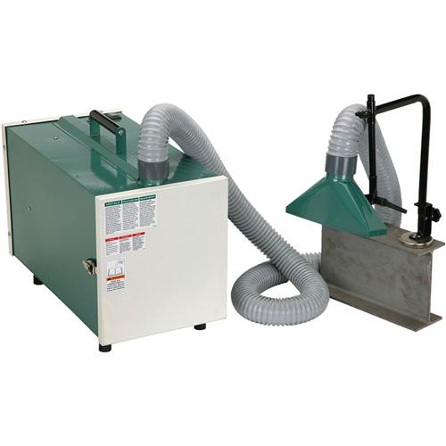

H8375 Grizzly Portable Fume Extractor
Capture welding fumes right at the source.
The H8375 Portable Fume Extractor helps collect and recycle shop air that is contaminated with welding dust, oily smoke, and fumes.
It is not designed to be a "single-solution" air cleaner and should not substitute respirator or fresh-air type respirator use.
Not suitable for CNC lasers
Often metals have coatings that produce very poisonous fumes when heated, so make sure that you are familiar with the types of fumes produced by the material that you are welding.
The H8375 can be permanently connected to a small welding downdraft table or moved to various welding locations.
Two squirrel-cage fans are located inside of the cabinet and draw welding dust, smoke, and fumes through the suction hood and then through a series of filters before the air re-enters the shop.
This filtration occurs in the following five stages:
Stage 1: Contaminated air enters the machine through a slag catch tray and then through a 1-2mm stainless steel screen that arrests sparks and collects minor welding slag.
Stage 2: Considered the first consumable pleated filter, this filter collects 35% of the 2-10 micron welding dust and most of the oily smoke.
Stage 3: The second consumable pleated filter catches 85% of the 1-2 micron dust and the remaining oily smoke.
Stage 4: This serviceable-type pleated filter, catches 45% of the 1-micron size particles.
Stage 5:This HEPA filter catches 99.97% of the 0.3-micron dust particles before the recycled air finally exits the machine and reenters the shop.
The H8375 comes with a one-year warranty which covers parts and assures the unit is free from factory defects.
The H8375 manual was written by our U.S.-based Technical Documentation Department and is packed with useful information. The complete and easy-to-read manual makes it easier to assemble and maintain your fume extraction system.
The Grizzly Customer Service and Technical Support Teams are U.S. based. Parts for the extractor may be available online and shipped from the Grizzly parts warehouse in Springfield, MO.
  • Motors: (two) 1 HP, 100V, single-phase, 15A
  • Intake hole size: 2-1/2"
  • Impeller: 5" aluminum
  • Airflow capacity: 230 CFM
  • Overall size: 14" W x 24-1/2" L x 19" H
  • Approximate shipping weight: 49 lbs.
  • Five stage filter system
  • Baffle and fine screen capture large solids and sparks
  • Includes 8' flex hose, 2-1/2" x 10" hood, and adjustable hood support with magnetic and clamp-on base
INCLUDES:
  • Stainless screen 1-2mm
  • Pleated filter 2-10 micron
  • Pleated filter 1-2 micron
  • Pleated filter 1 micron
  • HEPA filter 0.3 micron
