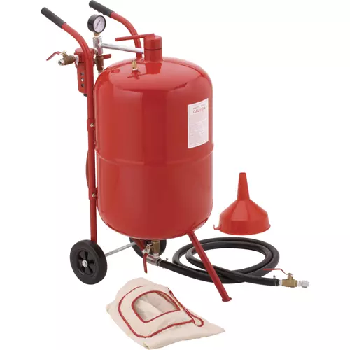

T27158 Portable Sandblaster, 20-Gallon
The T27158 features a pressurized tank for more sandblasting power as well as a pressure gauge and a safety pressure relief valve.
The self-emptying moisture trap makes it convenient to use.
Includes blasting hood, funnel, and four ceramic replacement tips.
The T27158 manual was written by our U.S.-based Technical Documentation Department and is packed with useful information. The complete and easy-to-read manual makes it easier to assemble and maintain your sandblaster.
  • Operating air pressure range: 65-125 PSI
  • Recommended air supply: 6-25 CFM
  • Blasting hose length: 10'
  • Tank size: 20-gallon
  • Abrasive capacity: 80 lbs.
  • Abrasive type: Dry only
  • Lighting type: 15W LED
  • Tip bore sizes: 0.065", 0.095", 0.115", and 0.135"
  • Overall dimensions: 15" W x 27-1/2" D x 35-1/2" H
  • Approximate shipping weight: 55 lbs.
We offer U.S.-based customer service and technical support to get your questions answered and help keep your equipment running in top condition. And to ensure your satisfaction, the T27158 comes with a 1-year warranty.
