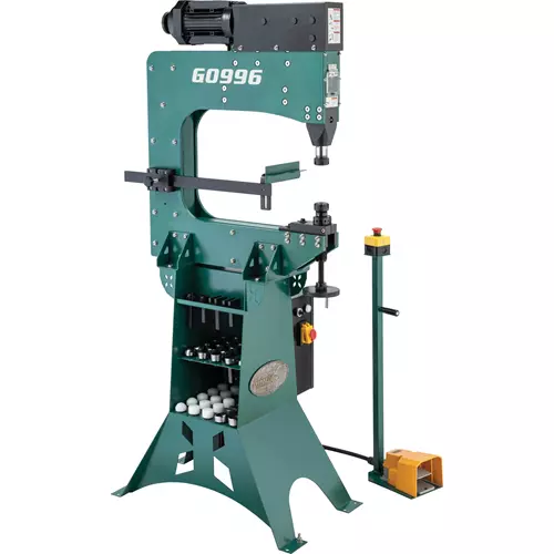

G0996 22" Power Hammer
Complete heavy forging tasks and produce superior quality sheet metal parts.
Streamline sheet metal-forming with this extremely quiet machine that generates a high-impact force to shape thick metal workpieces.
This power hammer includes numerous dies and lets you create your own tooling, so you can easily transform 16-gauge aluminum and 18-gauge mild steel.
Switch out tooling in seconds with the collet chuck; adjust the handwheels to provide needed clearance based on material thickness.
Use the rigid hammer action setting for direct operations including beading and flanges, and the dampened setting with springs for planishing, shrinking, and other unique processes.
The backstop and variable speed both provide additional versatility for easily completing any type of metal-forming task.
User-friendly speed controls ensure constant accuracy during operation, and steel construction guarantees machine strength.
Execute the full range of shaping functions including beading, doming, stretching, edge setting, louvres, and flanging for industries from automotive to airplane manufacturing with this efficient power hammer.
FEATURES and BENEFITS:
  • Die Options: Several die types provide flexibility and are easy to access with storage in the machine's base.
  • Customizable Tooling: Develop nearly any shape of tooling and use with universal tool holders that allow quick changes.
  • Dual Hammer Settings: The rigid setting lets you keep an exact depth for uniform processes, and the dampened setting for more customization.
  • Adjustable Backstop: Use it fixed for straight edges and with the roller for convex or concave curves.
  • Variable Frequency Drive: VFD for smooth, high-torque variable speed using single-phase power.
  • Variable Stroke Speed: Easily adjust stroke speed via pedal or panel knob for exceptional end results.
  • Speed Controls: Conveniently operate the machine with mobile foot controls that include an emergency stop, or via the panel knob.
  • Steel Construction: The reinforced steel upper and lower frames provide the stability you need for intensive metal shaping.
  • Required power source: 110V, single-phase, min. 15A circuit
  • Motor: 1-1/2 HP, 110V
  • Throat height: 15-1/2"
  • Throat depth: 22"
  • Max. distance between hammer & anvil: 5-1/8"
  • Max. aluminum thickness: 16-Gauge
  • Max. mild steel thickness: 18-Gauge
  • Stroke speed (blows per minute): Variable, 0-960 BPM
  • Stroke length: 1/4"
  • Anvil travel: 3-5/8"
  • Overall dimensions: 21-1/2" x 49" x 71"
  • Approximate shipping weight: 450 lbs.
