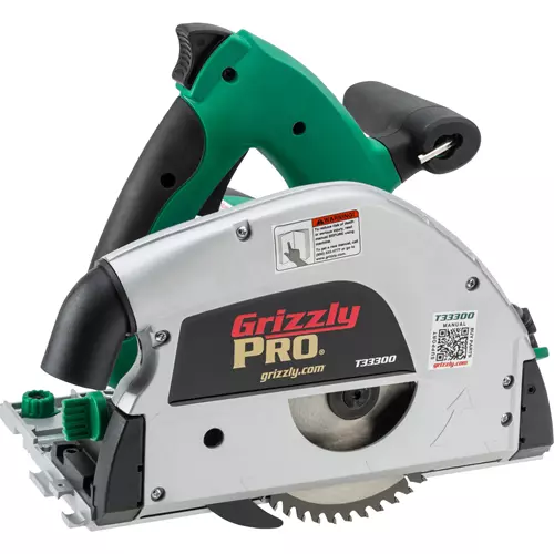

T33300 Grizzly PRO 6-1/4" Track Saw (Tool Only)
A competitively-priced plunge-cut track saw.
The plunge-cutting action of the T33300 6-1/4" Track Saw cuts large sized materials such as solid wood worktops, sheets of plywood, and double-coated MDF boards.
Eliminates over-extended reaching and poor balance while cutting wide panels.
A track saw performs both straight cuts and plunge cuts. Plunge cuts work well for removing an area within the workpiece; straight cuts rip long pieces from end to end.
It has a built-in riving knife to reduce the risk of kickback.
Cutting depth is easily adjustable by setting a lock knob. A depth scale conveniently displays in 1/32" increments from 0–2-1/2".
The T33300 6-1/4" Track Saw is sold as the saw only.
The T25667 28" Guide Rail is available for sale.
The T25094 Accessory Pack may be purchased separately. This kit includes two rail clamps that firmly secure the guide rail without hindering saw travel, a rail connector for joining two guide rails when ripping full length plywood, a limit stop, and an anti-tilt bar.
The T33300 manual was written by our U.S.-based Technical Documentation Department and is packed with useful information. The complete and easy-to-read manual makes it easier to assemble and maintain your saw.
  • Motor: 1-1/2 HP, 120V, single-phase, 9A
  • Saw blade: 6-1/4" x 48 tooth
  • Blade rim speed: 9070 feet per minute
  • Arbor size: 3/4"
  • Cutting angle: 0–45°
  • Max cutting depth at 90°: without rail 2-5/32", with rail 1-31/32"
  • Max cutting depth at 45°: without rail 1-5/8", with rail 1-7/16"
  • Dust port diameter: 1-1/2"
  • Overall dimensions: 12-1/2" W x 9" D x 10-1/2" H
  • Approximate shipping weight 16 lbs.
  • Anti-kickback design with spring-loaded riving knife
  • Low-profile blade guard for cuts as close as 5/8" from wall
  • Precision depth control scale in 1/32" increments from 0–2-1/2"
  • 1-1/2" Dust port for efficient dust collection
  • Operates with or without track
  • 1-year limited warranty
  • Includes 48-tooth carbide tipped blade!
