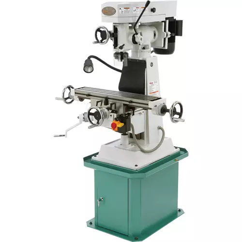

These are beautifully produced, accurate machines that are far more than just a step above a mill/drill. They feature a tilting head, a knee, one shot lubrication, satin finished dials, 9 speeds and so much more.
  • Motor: 1-1/2 HP, 110V/220V, single-phase, TEFC, prewired 110V
  • Spindle taper: R-8
  • Spindle travel: 3"
  • Swing: 11"
  • Max. distance spindle to table: 12-1/2"
  • T-Slots: 3 @ 1-9/16" centers, 1/2" wide
  • Table size: 6-1/8" x 26"
  • Table travel (longitudinal): 15-5/8"
  • Table travel (cross): 6"
  • Max. drilling capacity for cast iron: 1"
  • Max. drilling capacity for steel: 3/4"
  • Head tilt: 45° R & L
  • Ram swiveling angle: 45° R & L
  • Number of speeds: 9
  • Range of speeds: 240–2760 RPM
  • Overall dimensions: 45-1/2" W x 66-5/8" H x 41" D
  • Approximate shipping weight: 904 lbs.
Features:
  • High precision-ground vertical and cross ways
  • Milling head micro-feed
  • Head tilts to 45° both ways. 45° rotation on horizontal surface
  • Lower noise and convenient operation
  • Built-in worklight
  • Tapered roller Class 7 spindle bearings
  • One-shot lubrication
