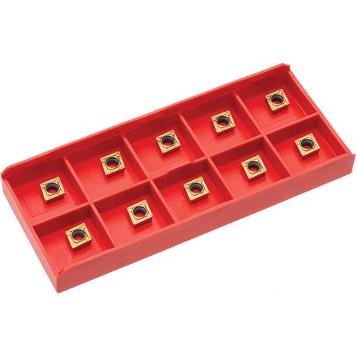

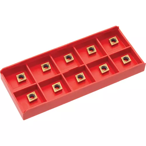

T34475 Harlingen® All-Purpose CCMT Carbide Inserts, 10-Pk.
Specifically designed for insert turning tool, indexable end mill, and boring bar sets, these all-purpose carbide inserts offer exceptional cutting across a broad range of materials, including steel, stainless steel, and cast iron. Designed with a positive geometry, they provide a clean-cutting action and offer four usable cutting edges for reliable material removal.
Advanced TiAlN Coating: The titanium aluminum nitride (TiAlN) coating provides exceptional hardness and superior wear resistance. This enables the cutting edge to maintain and form a self-protective aluminum oxide layer as it wears. This results in superior wear resistance, enabling higher cutting speeds and greatly extended tool life.
These inserts provide a reliable and cost-effective solution, ensuring performance you can depend on in a variety of machining applications.
FITS:
  • H5680 Insert Turning Tool Set, 5/16"
  • H5681 Insert Turning Tool Set, 1/2"
  • H5689 Indexable End Mill Set, 3/8"–5/8"
  • T34450 Multi-Purpose Indexable Tool Set, 1/4"
  • T34451 Multi-Purpose Indexable Tool Set, 3/8"
  • T34454 Indexable Boring Bar Set, 5/16"–5/8"
  • T34455 Indexable Boring Bar Set, 3/8"–5/8"
  • Designation: CCMT060204
  • Insert shape: Diamond (Rhombic)
  • Insert angle: 80°
  • Clearance angle: 7° Positive
  • Tolerance class: M
  • Insert size: 6.35mm (1/4") I.C.
  • Insert thickness: 2.38mm (3/32")
  • Nose radius: 0.4mm
  • Insert material: Carbide
  • Insert coating: TiAlN
  • Target materials: Steel, stainless steel, cast iron
  • Quantity: 10
Upgrade your machining operations with these CCMT060204 carbide inserts.
