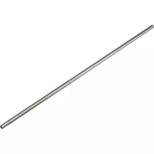

T10771 Grizzly Rod #2, .25 Cal to 7mm
A grizzly rod is used to help set up a rifle barrel for chambering.
These rods are 12 inches long and are the same rods used in the T34156 Grizzly Gunsmithing Video.
Grizzly rods come in different sizes, generally, categorized by the calibers they can work with:
  • #2: Fits calibers from .25 cal to 7mm
  • While grizzly rods are not caliber-specific, they can be used with various calibers within their size range. This is achieved using different sized pilot bushings.
    These bushings are inserted into the grizzly rod and match the specific caliber being chambered.
    The T10771 Grizzly Rod #2 only comes with 1 standard .25 cal bushing.
    To more precisely fit individual .25 cal barrels, you’ll need the T10778 9-Piece .25 Bushing Set.
    These bushings range from 0.2492" and 0.2508" in .002" increments.
    Other bushing sets for the #3 grizzly rod include:
    • .264 Caliber, T10780: .2552" to .2568"
    • .270 Caliber, T10781: .2692" to .2708"
    • .284 Caliber, T10782: .2754" to .2770"
    • Note: Cannot be shipped outside of the United States.
