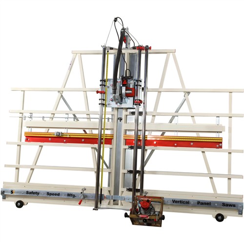

T33602 Safety Speed SR5 Vertical Panel Saw & Router Combination
For shops with limited space, this machine is ideal where both panel sizing and routing are required.
Cutting and routing full sized panels is often a job that’s dreaded in the shop due to effort required or fear of getting too close to exposed tooling.
The T33602 Safety Speed SR5 Vertical Panel Saw & Router features a heavily guarded blade and can be changed from a saw to a router in under a minute, all while delivering an accuracy of 1/64” straight and square.
The SR5 is ideal for shops doing extensive cutting, and dado or rabbet routing.
The interchangeable motor carriage features a rotating saw and router for sizing panels by pushing the panel through and making a ripcut, or by letting gravity take control and pushing the saw or router down for making a vertical crosscut.
The patented self-adjusting, floating router carriage provides a consistent depth of cut.
Safety Speed's MID-WAY Fence® allows for processing smaller panels at waist level.
If both panel cutting and routing are part of your operation, why not consider one machine that will do both?
Photos are shown with a stand, and wheels which are optional accessories.
Note: You can use either 1/4" or 1/2" collet router bits for the router.
Contact Safety Speed regarding technical support and their manufacturer warranty.
CSA certified
Please note: This item has a lead time of two weeks from time of order.
Due to product size, this item must be delivered to a loading dock or unloaded with a forklift. Liftgate service is not available.
Orders shipping outside of the lower 48 states will require a special quote.
  • Weight: 538 lbs
  • Dimensions: 120" x 11" x 83"
  • Maximum cutting height: 62"
  • Maximum rip cut: Unlimited
  • Maximum cut thickness: 1-3/4"
  • Saw blade diameter: 8"
  • Router bit collet: 1/4" or 1/2"
Features:
  • 3 1/4 hp, 15 amp Milwaukee Tool saw motor
  • 1 3/4 hp, 11 amp Milwaukee Tool router motor
  • 10' welded steel frame
  • Chrome-plated 1-3/4" guide tubes
  • 8 nylatron roller bearing system
  • Adjustable vertical and horizontal rulers
  • Quick change from vertical to horizontal cutting
  • Enclosed counter weight system
  • Integrated dust collection bonnet
  • Thin material pressure guard
  • Injection molded plastic rollers
  • Adjustable floating router head
  • Mid-Way Fence with stop
  • Mid-Way Fence flip stop
  • 4 material clamps
  • 2 blind dado stops
