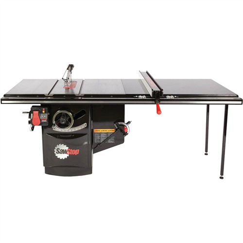

T30415 10" 5 HP 3-Phase Industrial Table Saw with 52" T-Glide
Meet the heaviest, most powerful 10" cabinet saw in its class: the SawStop Industrial Cabinet Saw lineup. Engineered for heavy production workloads, this saw is not only designed for maximum runtime, but delivers the utmost in safety thanks to SawStop's Contact Detection Technology that stops the blade on contact with skin. Rest assured knowing this industrial line of table saws is on the job and keeping you and your workforce safe with a built-in lockout/tag-out switch. The under table dust shroud is also capable of collecting up to 99% of generated dust when hooked to a good dust collector.
Features
  • Heavy duty T-glide fence and rail
  • Full wrap blade guard & under table dust shroud
  • Industrial lockout/tag-out switch
  • Control box with onboard startup computer
  • Gas assist trunnion & large blade arbor for less vibration
  • 2-Year Warranty
Specifications
  • Motor: 5 HP, 3-phase, 230V, 60Hz
  • 52" T-glide Fence System
  • Cabinet footprint: 20"W x 25"D
  • Cast iron table: 24"W x 30"D
  • Extension table with 52" rails: 40"W x 30"D
  • Blade: Professional grade, 5/8" arbor
  • Blade diameter: 10"
  • Dado diameter: 8"
  • Max depth of cut, blade at 45°: 2-1/4"
  • Max rip right of blade - 52": 52-1/2"
  • Max rip, left of blade: 12-1/2"
  • Weight w/ 52" fence: 685 lbs.
