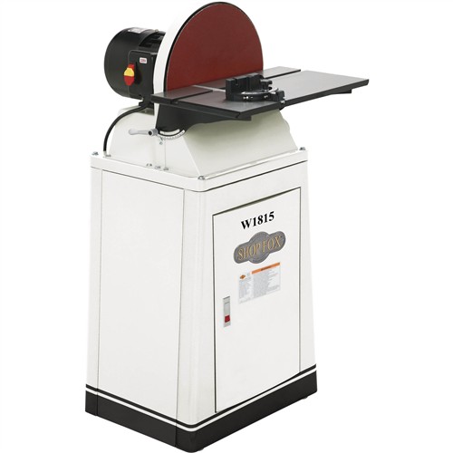

Shop Fox W1815 15" Disc Sander with Brake
Precision disc sanding for demanding projects.
Achieve flawless edges and efficient sanding with the 15" Disc Sander. It is a heavyweight performer designed to tackle your toughest sanding challenges. Here's why it belongs in your workshop:
  • Exceptional Precision: The precision-ground cast-iron table and disc platen ensure perfectly flat and square sanding results, ideal for working on long edges, end grain, and detailed sanding tasks.
  • Large Capacity, Effortless Control: The spacious 15" disc and 12" x 20" cast-iron table accommodate a wide range of project sizes. The table tilts from +15° to -45° for added versatility in sanding angles.
  • Fast Stops & Efficiency Features: The electronic braking system brings the disc to a complete stop within 3 seconds of powering off, enhancing safety and workflow. X and Y-axis miter slots and a miter gauge provide precise control for accurate sanding.
The cast-iron table and cabinet stand ensure long-lasting performance.
The cabinet stand has ample storage and includes a shelf to keep your sanding discs organized.
The W1815 accepts 15" diameter PSA sanding discs, which are available in a variety of grits.
The W1815 manual was written by our U.S.-based Technical Documentation Department and is packed with useful information. The easy-to-read manual provides full instructions on how to assemble and maintain your sander.
  • 1-1/2 HP, 220V, single-phase, 12A
  • Disc size: 15" PSA
  • Disc speed: 1725 RPM
  • Table size: 20" W x 12" D
  • Table tilt: -15° to –45°
  • Floor-to-table height: 37"
  • Dust port: 2-1/2"
  • Footprint: 26" W x 20-1/2" D
  • Overall dimensions: 26" w x 20-1/2" L x 46" H
  • Approximate shipping weight: 194 lbs.
  • Two-year warranty!!
  • Automatic internal motor braking system
  • Table tilt range -15° to 45°
  • Accepts 15" PSA discs
  • Large tilting precision-ground cast-iron table
  • X- and Y-axis miter slots
  • Miter gauge
