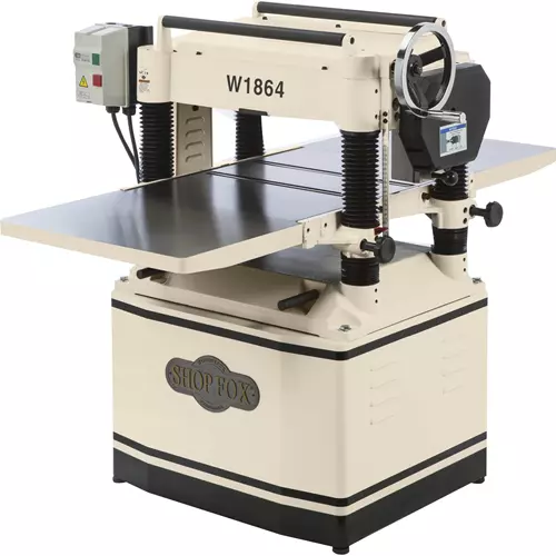

W1864 Shop Fox 20" 5 HP Planer
The W1864 Shop Fox 20" 4-knife planer with precision-ground cast-iron extension wings has the quality, capacity, and features to be a proud addition in any shop.
Its 5 HP motor will handle material up to 20" wide by 8-5/8" thick, and its two feed speeds will give you the option of running at 956 cuts per foot, or a finer 1222 cuts per foot.
Check out all of the other great features and you’ll agree, this is one fine machine!
CSA certified
  • Motor: 5 HP, 220V, single-phase, 23A
  • Maximum stock width: 20"
  • Maximum stock thickness: 8-5/8"
  • Minimum stock thickness: 1/4"
  • Minimum stock length: 7"
  • Maximum cutting depth planing full width: 3/32"
  • Maximum cutting depth planing 6" wide board: 1/8"
  • Cutterhead diameter: 3-1/4"
  • Cutterhead type: 4-Knife
  • Knife size & type: 20" x 1" x 1/8", HSS
  • Cutterhead speed: 5,000 RPM
  • Feed rate: 16 & 28 FPM
  • Table size with extensions: 20" x 56"
  • Dust port size: 5"
  • Footprint: 23" x 27-12"
  • Overall dimensions: 39" W x 58" D x 45" H
  • Approx. shipping weight: 816 Lbs.
  • Two-year warranty!!
  • Precision-ground cast-iron table and extension wings
  • Extra-large ball-bearing return rollers
  • Cabinet-style stand
  • Triple V-belt driven cutterhead
  • Two-speed chain-driven automatic feed rollers
  • Hardened anti-kickback fingers
  • Four heavy-duty headstock support columns
  • Internally mounted 5 HP motor
  • Large side-mounted handwheel
  • Oil-bath style gearbox for drive system
  • Includes knife-setting jig
  • Powder-coated finish
