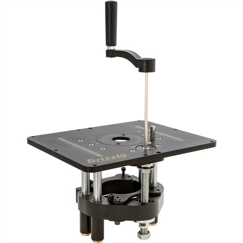

T31637 Router Lift with 12" x 9" Table Insert
Upgrade your router table with a router lift for the ultimate usability.
The T31637 Router Lift with 12" x 9" Table Insert provides you with the ability to change router bits and make fast, incredibly precise height adjustments from above the table.
Since the plate is 3/8" thick, the router lift will only work with router tables that have a 3/8" deep ledge.
This manually operated router lift features a removable crank handle with a graduated dial for making ultra-precise height adjustments.
The T31637 comes with a bracket for storing the crank handle when not in use.
The table insert measures 3-3/4" O. D. and has a 1-1/4" opening. It snaps into the center of the mounting plate and provides additional safety and control near the router bit during router operations.
The T31637 is designed with clamping plates that accept router body diameters of 3.2", 3.5" or 4.2."
  • Suitable routers for mounting: 3.2", 3.5", 4.2"
  • Plate size: 12 x 9 x 3/8"
  • Plate opening size: 3-3/4"
  • Table insert size: 3-3/4"
  • Table insert opening size: 1-1/4"
  • Router lift travel: 2-3/4"
  • Router lift index ring increment: 0.05" per full turn
  • Overall dimensions: 12" W x 9" D x 7-1/2" H
  • Approximate shipping weight: 14 lbs.
  • Precision-Machined Router Lift
  • Inch/Millimeter Settings
  • Index Ring for Fine Lift Adjustment of Router
INCLUDES:
  • Table Insert w/1-1/4" Diameter Bit Hole
  • Table Insert Wrench
  • Starting Pin
  • Hex Wrench 3mm
Note: The T31637 Router Lift fits the T28780 Router Table and T28781 Router Table only.
Note: The T31637 Router Lift is not compatible with the T32461 Router Motor.
