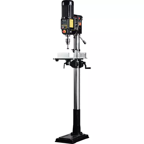

Teknatool T33237 - Nova Viking 16" Floor Model Drill Press with Fence
T33237 Nova Viking 16" Floor Model Drill Press
A groundbreaking redesign on a floor model drill press.
The T33237 Nova Viking 16" Floor Model Drill Press features a 1 HP DVR Smart Digital Motor delivering correct speed and power to maintain optimal torque direct to the drill head across the entire speed range.
The DVR technology brings unprecedented functionality and power to this drill press, with unrivaled torque and smoothness in this category. This makes it the perfect choice for projects like hole drilling, mortising and high-speed sanding.
The electronic variable speed varies between 150–3000 RPM (programmable to 5000 RPM).
The large, easy-to-read digital readout allows you to choose between metric or imperial (decimals or fractions) and is easy to switch between modes.

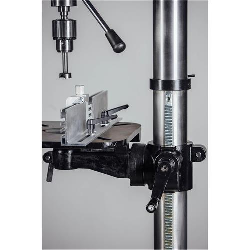

The built in LED lights and laser location makes it easy to see clearly and locate your center.
Add to all of this an electronic depth stop, solid cast-iron table with fence and self-start to enable one-handed drilling, you can have a machine that just can't be beat!
