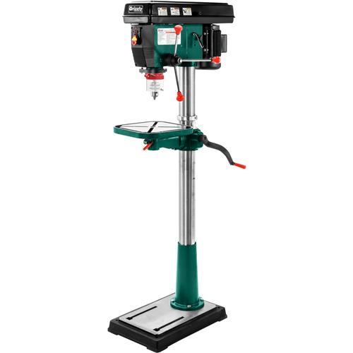

G7947 17" Floor Drill Press
A drill press with plenty of power and spindle travel.
The G7947 17" Floor Drill Press boasts 1-1/2 HP motor that smoothly powers the twelve spindle speeds ranging from 180 to 3240 RPM.
It can easily drill holes through fiberglass, plastic, and composites, and has a maximum capacity to drill through an inch of steel without bogging down.
The G7947 comes prewired 120V or can be converted to 240V. If you prefer 240V, refer to the Voltage Conversion instructions in the manual
The JT3 keyed drill chuck is fitted to the MT #3 spindle taper and offers up to 4-3/4" of travel. The chuck accepts drill bits from 3/64" to 5/8". You can set the adjustable depth stop for predetermined and repeatable drilling.
The 13-5/8" by 13-5/8" tables has four 5/8" T-slots for clamping your workpieces down.
To make sure that you get the best use of the table, the drill press features rack-and-pinion elevation controls—adjustable 21-1/2" vertically, 90° tilt (left and right) and is capable of 360° rotation around the column.
Finally, the precision-ground work surface on the base contains two more 1/2" T-slots, ensuring that every surface can be put to use.
The G7947 manual was written by our U.S.-based Technical Documentation Department and is packed with useful information. The complete and easy-to-read manual makes it easier to assemble and maintain your drill press.
Made in an ISO 9001 Factory
CSA certified
- Motor: 1-1/2 HP, single-phase, 120V/240V (prewired 120V), 15.8A/7.9A
- Swing: 17"
- Drill chuck: 3/64"-5/8"
- Drilling capacity: 1" steel
- Spindle taper: MT #3
- Spindle travel: 4-3/4"
- Number of speeds: 12, 180–3240
- Quill diameter: 2.85"
- Table T-slot size: 5/8" wide
- Table size: 13-5/8" x 13-5/8"
- Table swing: 360 degrees
- Table tilts: 90° L/R
- Footprint: 22-1/2" x 14-1/2"
- Overall size: 21" W x 30" D x 70" H
- Approximate shipping weight: 260 lbs.
