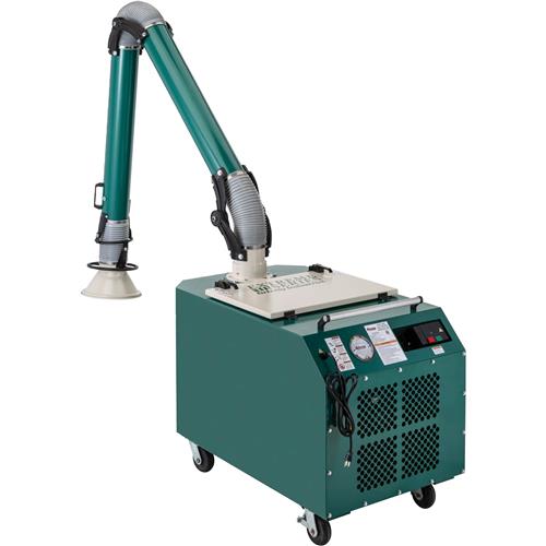

G0964 1-1/2 HP Portable Fume Extractor with Precision Arm
Purify your shop air with this versatile HEPA fume extractor.
This unique fume extraction machine removes fumes from your shop environment, providing the safe and clean air you need for continued metalworking production.
It features a 10' rotating arm for reaching over and around other machines to direct the suction wherever you need it.
By adding this machine to your metalworking equipment lineup, you will minimize safety issues caused by welding, cutting, or grinding.
The 850 CFM of airflow performance provides the suction needed for efficient air movement through each of the filters.
The four-stage filtration starts with a spark arrestor aluminum mesh filter, and then the particles pass through a stainless steel mesh filter.
Whatever hasn’t been removed with the first two filters moves through a pleated pre-filter, which takes care of particles between 2 and 10 microns.
A V-Cell HEPA filter is the final stage of the filtration process. It filters 99.97% of particles down to 0.3 microns. For reference, a human hair is between 50–70 microns in diameter, meaning the G0964 collects particles 230 times smaller!
You won’t believe the difference that intensive fume extraction makes in the quality of your shop atmosphere!
The G0964 manual was written by our U.S.-based Technical Documentation Department and is packed with useful information.
Fume extractor parts may be available online and shipped from the Grizzly parts warehouse in Springfield, MO.
  • Motor: 1-1/2 HP, 120V/240V (prewired 120V), single-phase, 18A/9A
  • Airflow capacity: 850 CFM @1.72" SP
  • Maximum static pressure: 7.02"
  • Extraction arm length: 10 feet
  • Extraction arm diameter: 6"
  • Extraction arm rotation: 350°
  • MERV rating: MERV-17
  • Third-stage filter rating: 2–10 Microns @ 35%
  • Fourth-stage filter rating: 0.3 Microns @ 99.97%
  • Main inlet size: 6"
  • Overall dimensions: 29-1/2" W x 88-1/2" D x 84" H
  • Approximate shipping weight: 601 lbs.
  • 6" x 10-foot arm to direct suction to where needed
  • Built-in damper on precision arm for adjusting air flow
  • Combined filter surface area of 177.6 square feet
  • V-cell MERV-17 HEPA filter collects 99.97% of particles at 0.3 microns
  • Vacuum pressure gauge indicates when to clean and replace filters
  • Steel body with two locking caster wheels
  • Removable dust drawer
  • 1-year limited warranty
