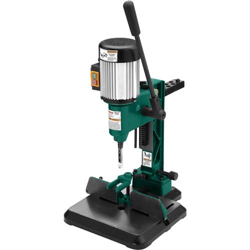

G0645 1/2 HP Benchtop Mortising Machine
Cut straight and clean mortises.
A mortising machine, mortiser machine, or mortiser for short, cuts square holes in lumber. This is an especially quick and helpful tool for cutting mortise and tenon joints.
The G0645 1/2 HP Benchtop Mortising Machine offers an effective combination of features including the rack-and-pinion fence, six-position handle, and riser block that added 1-1/4" stroke to the column.
Rigid cast-iron construction and rack-and-pinion head control on a dovetail column help ensure this mortising machine will produce precision mortises every time.
A pneumatic return strut eases the step-and-repeat cycle when making multiple mortises. A riser block is also included to increase the maximum stock thickness to 6". When using the riser block with this mortiser, the included fence may not provide adequate support. Customers may find it necessary to use an auxiliary fence to ensure proper alignment and stability.
The 1/2 HP motor powers through any type of wood and the easy-access drill chuck makes it simple to change chisels. The G0645 comes with four mortising chisels!
Shop our lineup of mortising chisels for various sizing needs.
The maximum chisel size for this benchtop mortising machine is 5/8"
Like all of the Grizzly mortising machines, the G0645 comes with a 1-year warranty covering parts and assuring the unit is free from factory defects. (Consumables are not covered by the warranty.)
The G0645 manual was written by our U.S.-based Documentation Department is packed with useful information.
The Grizzly Technical Support team is U.S.-based. Parts for the mortiser machine may be available online and shipped from the Grizzly parts warehouse in Springfield, MO.
  • Motor: 1/2 HP, 110V, single-phase, 6A
  • Spindle speed: 1725 RPM
  • Spindle taper: JT #2
  • Spindle travel: 3-1/4"
  • Maximum stock width: 8-1/2"
  • Maximum stock thickness without extension block: 4-1/4"
  • Maximum stock thickness with extension block: 6"
  • Maximum mortising depth: 3"
  • Maximum chisel travel: 4-5/8"
  • Maximum distance column to chisel: 5"
  • Chisel size range: 1/4"–1/2"
  • Chuck capacity: 3/8"
  • Collar size: 5/8"
  • Table size: 10-1/2" x 12-1/4"
  • Overall dimensions: 13-3/4" W x 29" D x 32" H
  • Approximate shipping weight: 76 lbs.
  • Tool storage rack on back of column
  • Dovetailed column and head
  • Includes 1-3/4" riser block for increased capacity
  • Rack-and-pinion fence movement (without riser block installed)
  • Dovetailed column with adjustable ways
  • Adjustable depth stop
  • Large table surface
  • Multi-positional handle
  • Cast-iron construction throughout
  • Includes four chisels: 1/4", 5/16", 3/8", 1/2"
We offer U.S.-based customer service and technical support to get your questions answered and help keep your equipment running in top condition. And to ensure your satisfaction, the G0645 comes with a 1-year warranty.
