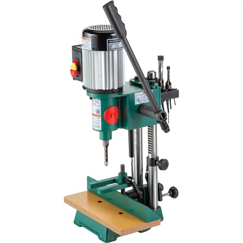

T33127 Benchtop Hollow Chisel Mortiser
A benchtop mortising machine for cutting square holes.
The T33127 Benchtop Hollow-Chisel Mortiser was awarded “TOP VALUE” by Wood Magazine based on its hardware and superior functionality over others on the market.
It come with three, four-sided chisels surrounding a drill bit to cut square holes. This machine can also double as a drill press when chucking a drill bit up to 1/2" in size.
The multi-positional handle allows you to adjust the depth of the plunge for various workpiece thicknesses. Adjust the handle position to ensure the chisel fully reaches the desired depth for your project.
The 1/2 HP motor, easily adjustable depth stop, and smooth rack-and-pinion head travel will make consistent, easy work of mortises in even the hardest of wood types.
The double steel support columns are well suited for day-to-day operations and they save on the encumbering weight of solid cast-iron construction.
The T33127 is light enough to be easily moved around the shop, yet still maintain rigidity for repeatable precision mortises.
There is even a built-in tool storage rack on the back of the headstock for convenience.
  • Motor: 1/2 HP, 120V, single-phase, 5A
  • Spindle speed: 1725 RPM
  • Spindle taper: B16
  • Spindle travel: 4-1/4"
  • Maximum stock width: 13-3/8"
  • Maximum stock thickness: 4"
  • Maximum chisel travel: 4-7/8"
  • Maximum mortising depth: 3"
  • Maximum distance column-to-chisel: 5-1/8"
  • Maximum chisel size: 1/2"
  • Chuck size: 1/2"
  • Collar size: 3/4"
  • Table size: 13-1/2" x 6"
  • Base footprint: 10" x 8"
  • Overall dimensions: 13-1/2" W x 22" D x 30-1/2" H
  • Approximate shipping weight: 67 lbs.
  • Multi-positional handle
  • Double support columns
  • Adjustable depth stop
  • Extra chuck and arbor allows mortiser to double as a drill press
  • Chuck guard
  • Spring-tension fence with depth stop
  • Storage rack for tools
  • Gas spring for head return
  • Coarse and fine fence adjustment
  • 1/4", 3/8", and 1/2" chisels
We offer U.S.-based customer service and technical support to get your questions answered and help keep your equipment running in top condition. And to ensure your satisfaction, the T33127 comes with a 1-year warranty.
