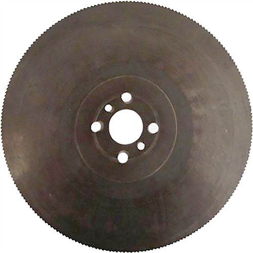

T33199 10" 120T ATB Cold Saw Blade
Cold cut saws are designed to cut ferrous and non-ferrous metals at low speeds.
The T33199 Cold Saw blade is made from M2 HSS (high-speed steel) that has been heat treated for hardness and wear resistance.
The ATB tooth pattern stands for Alternate Tooth Bevel where the bevel alternates in opposite directions every tooth with 120 teeth in total.
This blade has three sets of universal pin holes at 2/8/45 + 4/9/50 + 2/11/63. (2/8/45 = 2 bolt holes which are 8mm in diameter on a 45mm bolt circle.)
T33199 is compatible with the T28366 10" Slow Speed Cold Cut Saw.
The T33199 comes with a 1-year warranty which assures the blade is free from factory defects.
  • Tooth count: 120
  • Tooth pattern: ATB BW
  • Diameter: 9-13/16" (250mm)
  • Pin holes: 2/8/45 + 4/9/50 + 2/11/63
  • Bore: 1-1/4" (32mm)
  • Thickness: 2mm\
