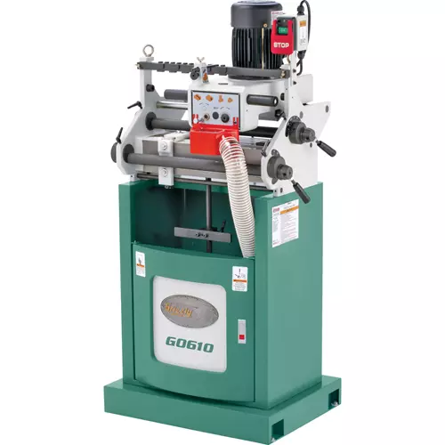

Grizzly G0610 - 11-1/4" Dovetail Machine
1.0 (1)
$4,125.00
G0610 11-1/4" Dovetail Machine
Make strong and attractive half-blind dovetailed joints faster than you ever thought possible.
The powerful 1 HP induction motor of the G0610 11-1/4" Dovetail Machine makes cutting joints quick while the four-sided template makes it easy to change styles.
Quick cam clamps make for fast changes and having all adjustments clearly described right on the machine insures an easy set-up and adjustment.
Increase your shop's profits by creating your own four-sided drawers in just a few minutes each.
Prewired for 110V, the G0610 can plug into a standard 110V outlet or can be converted to operate on a 220V power supply. If you prefer 220V, refer to the Voltage Conversion instructions in the manual.
Like all Grizzly dovetail machines, the G0610 comes with a 1-year warranty which covers parts and assures the unit is free from factory defects.
The G0610 manual was written by our U.S.-based Technical Documentation Department and is packed with useful information. The complete and easy-to-read manual makes it easier to assemble and maintain your bandsaw.
The Grizzly Customer Service and Technical Support Teams are also U.S.-based. Parts for the dovetail machine may be available online and shipped from the Grizzly parts warehouse in Springfield, MO.
  • Motor: 1 HP, 110V/220V (prewired 110V), single-phase, 10A/5A
  • Number of spindles: 1
  • Spindle speed: 18,500 RPM
  • Dovetail bit: 10° x 5/8" long
  • Dovetail shank: 1/2"
  • Maximum dovetail height: 3/4"
  • Minimum dovetail height: 3/16"
  • Maximum thickness: 1-3/4"
  • Minimum thickness: 13/32"
  • Maximum stock size: 11-1/4" W x 28" L
  • Minimum stock size: 2-3/8" W x 7-7/8" L
  • Table size: 19-1/2" x 7"
  • Floor to table height: 38-5/16"
  • Overall size: 30-1/2" W x 22-1/2" D x 57" H
  • Approximate shipping weight: 418 lbs.
  • Cast-aluminum carriage
  • Steel stand
  • Hardened and ground chrome steel slide ways
  • Ball-bearing linear guides
  • Four-way dovetail template
  • Micro-adjustable spindle head
  • Workpiece stops
  • Quick cam clamp
  • 4" dust port
  • Spring-loaded carriage for smooth operation
