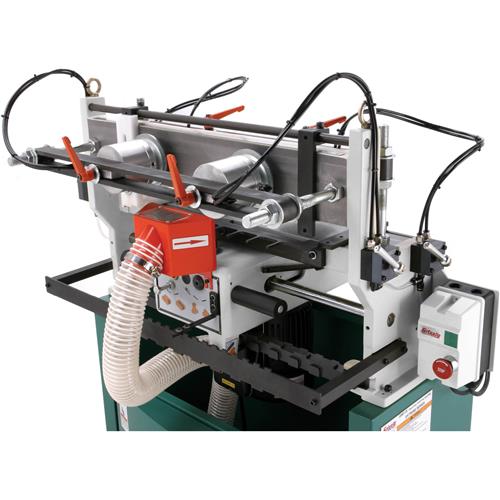

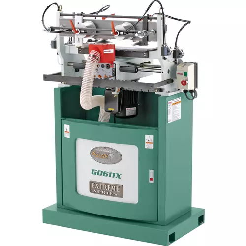

G0611X 16-1/2" Extreme Series Dovetail Machine
Produce strong and attractive half-blind dovetail joints at scale.
If you're wanting to upgrade from producing dovetails with a dovetail jig, this dovetail machine will quickly pay for itself!
The G0611X features pneumatic clamps for quickly loading workpieces and a 4-sided template for cutting 1", 1-1/2", 2", and 2-1/2" dovetails.
With the ability to cut two joints at a time, the G0644X can produce a 4-sided drawer in under two minutes if the boards are prepared properly.
Also spindle heads are micro-adjustable to give you complete control of dovetail "fit."
The H9388 replacement dovetail bits are available when your stock bits start getting dull.
  • Motor: 1 HP, 110V/220V (prewired 220V), single-phase, 10A/5A
  • Minimum circuit size: 15A @ 120V, 15A @ 240V
  • Number of spindles: 1
  • Spindle speed: 18,500 RPM
  • Dovetail bit: 10° angle x 5/8" long
  • Dovetail shank: 12mm
  • Maximum dovetail height: 3/4"
  • Minimum dovetail height: 3/16"
  • Maximum thickness: 2-3/8"
  • Minimum thickness: 13/32"
  • Maximum stock size: 59" long x 16-1/2" wide
  • Minimum stock size: 7-7/8" long x 2-3/8" wide
  • Table size: 24" x 7-3/4"
  • Floor to table height: 46-7/16"
  • Footprint: 37" W x 21-1/4"
  • Overall size: 38-5/8" W x 26-1/2" x 56-7/8" H
  • Approximate shipping weight: 539 lbs.
  • Micro-adjustable spindle head
  • Dual pneumatic clamping system
  • Four-way dovetail template
  • Cast aluminum, spring-loaded carriage
  • Precision-milled cast-iron table frame
  • Hardened and ground chrome steel slide ways
  • Quick air-cylinder clamp, air filter/regulator/lubricator with pressure gauge
  • Ball-bearing linear guides
  • Workpiece stops
  • 4" dust port
