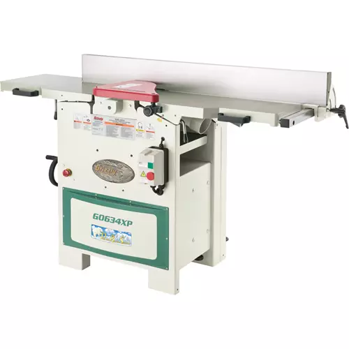

G0634XP 12" 5 HP Planer / Jointer with Helical Cutterhead
A compact and convenient combination machine.
The G0634XP 12" Planer/Jointer with Helical Cutterhead combines a powerful 5 HP motor with a 4-row helical cutterhead. Producing straight-on cuts up to 12" wide, the inserts sit square to the axis of the cutterhead, with the cutting edges perpendicular to the workpiece. The 32 indexable carbide insert cutters can each be rotated three times to expose new, sharp cutting edges.
The power is transferred from the 5 HP motor to the cutterhead by the twin V-belt design. This ensures maximum power connection between the cutterhead and the feed drive.
The jointer has a depth of cut scale on the front. The fence can be positioned at any angle between 45° and 90° as indicated by the tilt scale.
The planer features cast-iron infeed and outfeed tables, two feed rollers, anti-kickback fingers and a thickness scale.
Conversion from the jointer to the planer is easy. Just remove the quick-release fence and flip up the jointer tables. The heavy-duty cast-iron tables are precision-ground to a mirror-like finish.
