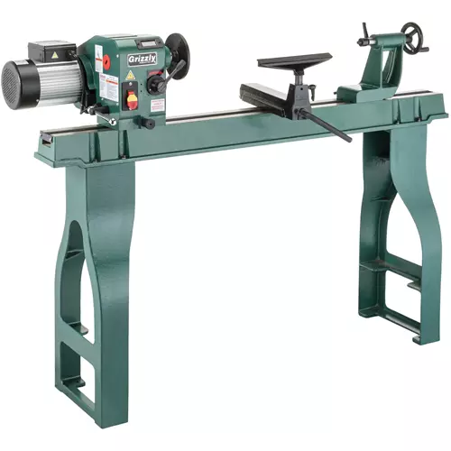

G0987 16" x 46" Variable-Speed Wood Lathe with DRO
Power, Precision, and User-Friendly Features for Your Next Woodturning Project
Get turning on your next workpiece with this multi-functional lathe! It includes features that beginners and small-shop professionals alike can appreciate, including the versatility of variable speed and power to turn even dense hardwoods.
With a built-in DRO you can monitor and adjust your speed to ensure precision for every turn – no more guesswork. The oversized tool rest base also increases accuracy and control, and the large 16" swing over bed and 46" distance between centers lets you tackle a wide range of woodworking projects.
A multi-positional headstock rotates between 0° and 180° for easy repositioning during outboard bowl turning, and quick-release levers streamline setup and repositioning. And there is no need to worry about stability and vibration with this lathe's heavy-duty, precision-ground cast-iron construction.
This 2 HP wood lathe is a great choice for hobbyists producing pens, lamp bases, and even unique items such as vases. Professional woodturners can create architectural columns, sizeable furniture components, and even decorative accents with the ease of variable-speed.
KEY FEATURES:
  • Variable-speed spindle
  • Built-in digital RPM readout
  • Large tool rest base for stability and easy positioning
  • Sizeable 16" x 46" capacity
  • Multi-positional headstock - 0°, 60°, 90°, 120°, and 180° rotation
  • Quick-release levers for tailstock and headstock
  • Precision-ground cast-iron bed and legs
  • One-year warranty
  • Motor: 2 HP, 120V, single-phase, 13A
  • Swing over bed: 16"
  • Swing over tool rest: 11-5/8"
  • Distance between centers: 46"
  • Spindle speed (variable): 600 - 2400 RPM
  • Spindle threads: 1” x 8 TPI
  • Spindle taper: MT#2
  • Tailstock taper: MT#2
  • Tool rest width: 11-3/4"
  • Footprint: 54" x 14"
  • Overall dimensions: 80" x 21" x 46"
  • Shipping weight: 316 lbs.
A variable-speed wood lathe with the extended capacity, precise readout, effortless positioning, and long-term durability needed to turn project after project.
Upgrade from a benchtop model with the Grizzly G0987 16" x 46" Variable-Speed Wood Lathe with DRO – order yours today!
