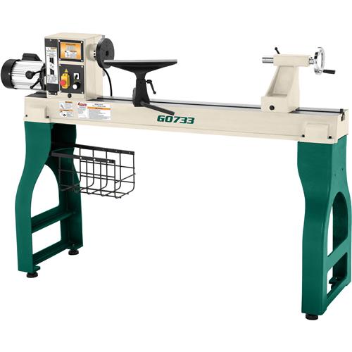

G0733 18" x 47" Heavy-Duty Wood Lathe
A large capacity wood lathe with VFD.
The G0733 18" x 47" Heavy-Duty Wood Lathe has it all, beginning with the 18" swing over bed capacity.
You'll appreciate the variable-speed spindle control with digital readout, forward/reverse switch and convenient tool storage basket.
The belt drive offers a low-speed range of 100–1200 RPM and a high-speed range of 330–3200 RPM.
The headstock can be rotated 180° and positioned anywhere along the bed. The tailstock, headstock, and tool rest support all have lever action cam locks for quick positioning.
ETL certified
  • Required power source: 240V, single-phase, min. 15A circuit
  • Motor: 2 HP, 240V
  • Swing over bed: 18"
  • Swing over tool rest base: 14"
  • Distance between centers: 47"
  • Spindle speed: Variable, 100–3200 RPM
  • Spindle threads: 1-1/4" x 8 TPI RH
  • Spindle taper: MT#2
  • Tailstock taper: MT#2
  • Tool rest width: 14"
  • Tool rest post diameter: 1"
  • Footprint: 20" x 65-1/2"
  • Overall dimensions: 81" W x 19-1/2" D x 48-1/2" H
  • Approximate shipping weight: 503 lbs.
  • Electronic variable-speed spindle control with digital readout
  • Cast-iron constructed bed and legs for stability and to minimize vibration
  • 10° spindle indexing
  • Headstock can be rotated 180°and positioned anywhere along the bed
  • Lever-action cam-locks for tailstock, headstock and toolrest base for quick positioning
  • Low speed range of 100–1200 RPM
  • High speed range of 330–3200 RPM
  • Forward/reverse switch
  • Emergency stop button
INCLUDES:
  • 6" Faceplate
  • MT#2 cupped live center
  • MT#2 spur center
  • Tool rest
  • Indexing pin
  • Knock-out rod
Need help? We offer U.S.-based customer service and technical support to get your questions answered and help keep your equipment running in top condition. And to ensure your satisfaction, the G0733 comes with a 1-year warranty.
