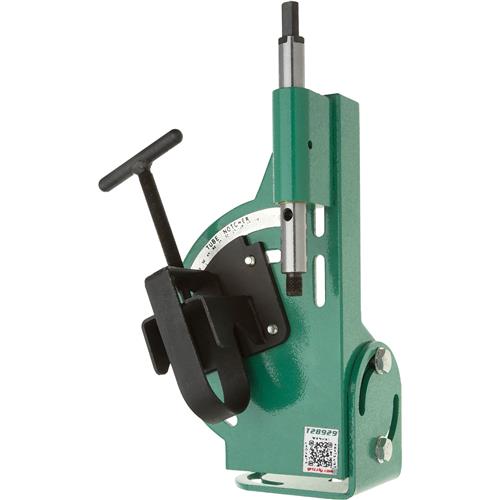

T28929 2" Pipe / Tube Notcher
Make joints for just about any structure yourself!
The T28929 2" Pipe/Tube Notcher cuts notches in pipe and tubing to make joints that fit together perfectly.
These close-fitting joints mean no hassles when welding, brazing, or using epoxy.
The T28929 allows you to make round cuts in pipes and tubing of various shapes at any angle between 0°–45°.
This tubing notcher has a maximum outer diameter (OD) capacity of 2 inches, which allows it to notch 2-inch tubing with a 2-inch OD. However, it cannot accommodate 2-inch pipes, as they have a larger OD of 2-3/8 inches, which exceeds the capacity of this tubing notcher.
The notcher features a durable steel frame to hold your workpieces rigid during operation.
This tool works with any standard drill press or slow-speed hand drill and is adaptable to a large variety of hole saws and milling bits.
Like all Grizzly notchers, the T28929 comes with a 1-year warranty which covers parts and assures the unit is free from factory defects.
Parts and accessories for your notcher may be available online and shipped from the Grizzly parts warehouse in Springfield, MO.
