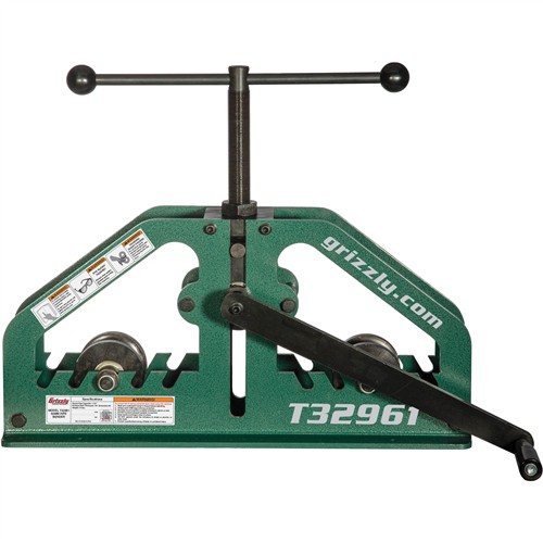

T32961 60mm Manual Tube Pipe Roller
A versatile portable radius roller that can be used on a benchtop and then stored away.
The T32961 Tube Pipe Roller is designed to make radius bends of round tubing, rectangular tubing, square tubing, and pipe.
The quick-change lower wheels have five slotted options in the frame to choose from based on the arc of the bend desired.
The rotary rod raises lowers the upper roller by twisting the Acme screw.
Insert your tubing onto the lower wheels and turn the crank to move the workpiece through. Repeat until the desired curve is achieved.
Additional tube rollers from 1/2"–2" and round pipe rollers from 1/4"–1-1/2" are available.
SPECIFICATIONS
  • Maximum bending angle 180°
  • Round pipe capacity: 1-1/2"
  • Round pipe minimum outer radius: 20"
  • Round tube capacity: 2"
  • Round tube minimum outer radius: Variable
  • Square tube capacity: 1/2"
  • Square tube minimum outer radius: 20"
  • Rectangular tube capacity: 1" x 2"
  • Rectangular tube minimum outer radius: 60"
  • Flat bar capacity: 1-1/4"
  • Flat bar minimum outer radius: 10"
  • Approximate shipping weight: 73 lbs.
  • One set of 1-1/2" round tube rollers
  • One set of 1-1/2" square tube rollers
  • Quick-change lower rollers
We offer U.S.-based customer service and technical support to get your questions answered and help keep your equipment running in top condition. And to ensure your satisfaction, the T32961 comes with a 1-year warranty.
