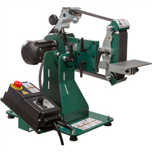

T32459 Knife-Making Belt Sander/Grinder
Shape and sharpen your custom knife blades with ease.
Recognized as one of the Best New Power Tools of 2024 on bobvila.com!
Do you have a 110-volt receptacle and want horizontal and vertical grinding? With this machine, you can have both.
Product testers on Bob Vila's website agree this lightweight and portable machine excels for the entry-level knife maker. Keep it on your workbench or easily store it when not in use.
You have complete control of the belt speed. The internally-grounded, variable-speed motor allows you to dial in the exact grind you need whether you're shaping or sharpening. This allows you to find that perfect balance between material removal and minimizing heat.
The sanding frame tilts 90° for horizontal or vertical knife shaping. The tool rest tilts 5°–120°, swivels, and adjusts in and out from the belt. The knife-grinding possibilities here are limitless.
It features a durable graphite-coated platen that reduces friction and can further help to prevent overheating and “bluing” of your knife blade. The platen tilts from -30° to 30° forward and back.
You can also “slack belt-sand” with the platen removed, thanks to the gas strut belt tensioner. This keeps the belt under constant tension while allowing you to deflect it back and forth with the knife blade. The gas strut also allows for quick and easy belt changes.
It comes with a 2" x 42" 120-grit silicon carbide belt, with additional belts are available.
The T32459 manual was written by our U.S.-based Technical Documentation Department and is packed with useful information. The complete and easy-to-read manual makes it easier to assemble and maintain your machine.
  • Motor: 3/4 HP, 110V, single-phase, 7.8A
  • Belt size: 2" x 42"
  • Belt speed: Variable, 131–4189 FPM
  • Belt tilt: 0–90°
  • Tool rest size: 6" W x 3" D
  • Overall dimensions: 15-1/2" W x 19" D x 18" H
  • Approximate shipping weight: 42 lbs.
  • Variable-speed motor that allows you to dial in the perfect belt speed.
  • Sanding frame pivots 90° for vertical or horizontal grinding
  • Adjustable tool rest swivels, moves in and out from the belt, and tilts from 5°–120°
  • Platen tilts from -30°to 30°
  • Quick-release belt lever with gas-strut tensioner for easy belt changes
  • Aluminum drive and idler wheels
  • 2" x 42" 120-grit silicon carbide belt included
  • 1-year limited warranty
