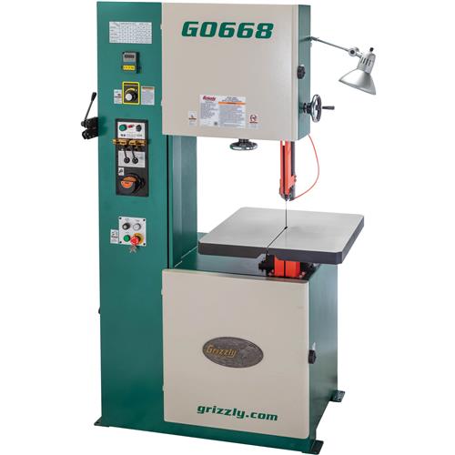

G0668 20" 2 HP Vertical Metal-Cutting Bandsaw
An efficient machine for most of your metal-cutting needs.
Enjoy the benefits of a large capacity vertical bandsaw with the ability to make internal cuts in one self-contained machine.
The G0668 20" 2 HP Vertical Metal-Cutting Bandsaw has a built-in blade shear, welder, and grinder allows you to cut the blade, feed it through the work piece and weld it back together again.
The blade is also cooled during the cut by an on-board air compressor and air nozzle so there’s no messy liquid coolant system.
The variable blade speed control lets you dial in the optimum speed for any type of metal-cutting job and the balanced cast-iron wheels ensure extremely smooth operation.
