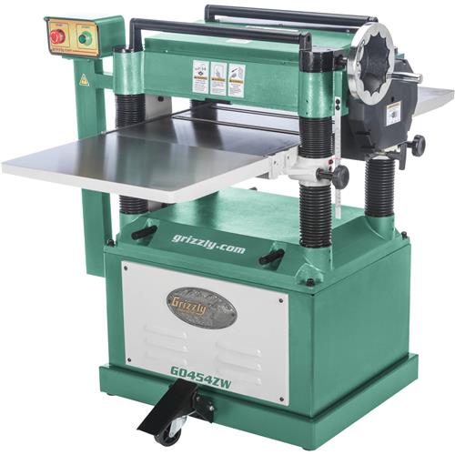

Image for Grizzly G0454ZW - 20" Planer with Spiral Cutterhead
Put one of these 20" planers in your shop without breaking the bank. Solid cast iron and steel construction and large planing capacity makes this a true heavyweight planer. However, with the foot-operated caster system, you won't need to manhandle this machine around your shop. You'll also appreciate the 56-1/2" long precision-ground table, 5HP motor, and the two-speed gear box for maximum versatility. Pound for pound, the best 20" planer value in the world!
  • Motor: 5HP, 240V, single-phase, 20A
  • Maximum cutting width: 20"
  • Maximum stock thickness: 8"
  • Minimum stock thickness: 3/16"
  • Minimum stock length: 7-1/2"
  • Maximum cutting depth: 1/8"
  • Cutterhead diameter: 3-1/16"
  • Number of carbide inserts: 96, 14 x 14 x 2mm
  • Insert size: 14 x 14 x 2mm
  • Cutterhead speed: 5000 RPM
  • Feed rate: 16 & 20 FPM
  • Solid serrated steel infeed roller
  • Table size: 56-1/2"L x 21"W x 2-3/8"H
  • Overall size: 56-1/2"L x 44"W x 45"H
  • Approximate shipping weight: 877 lb.
Features:
  • Built-in mobile base
  • Precision-ground cast iron table & wings
  • Board return rollers
  • Adjustable bed rollers
  • Four-column support with table locks
  • 5" dust port
