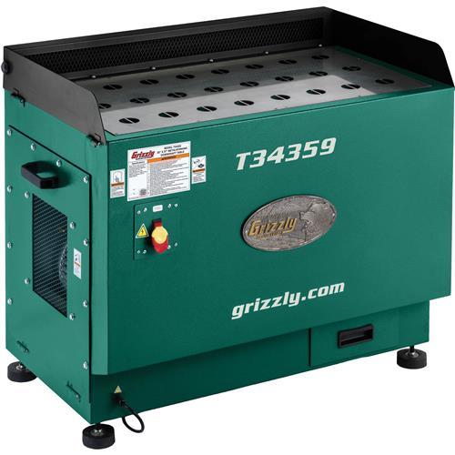

Tackle metal dust from grinding, sanding, soldering, and polishing with this essential metal shop accessory. The squirrel cage impeller offers 1850 CFM of powerful suction to draw down metal debris through holes in the steel table. Dual filters provide 200-micron filtration to maximize the amount of fine metal pieces that are removed from the air.
This quiet metal dust collector offers a semi-enclosed area so that you can work continually on your metal projects with minimal debris. The easily accessible clea-nout tray collects swarf to keep it off your equipment and shop floor. And with its compact size, it is an ideal choice for small metal shops and hobbyists who want to improve the safety and cleanliness of their work area.
FEATURES & BENEFITS:
  • Heavy-Duty Motor: The powerful 3/4 HP motor delivers 1850 CFM of airflow for maximum metal dust collection.
  • Stainless Steel Surface: Provides superior resistance to heat, corrosion, and wear from heavy metalwork.
  • Squirrel Cage Fan: A durable 9-1/2" x 7" squirrel cage fan efficiently moves air to pull in debris.
  • Efficient Dual Filtration: Two filters provide 200-micron filtration to remove a wide range of harmful particles from the air.
  • Quiet Operation: A sound rating of only 70 dB minimizes extra noise in your shop environment.
  • Self-Contained: Keeps your area mostly residue-free so you can work as effectively as possible.
  • Easy Cleanup: Includes a clean-out tray at the table's base that collects metal slag for easy disposal.
  • Compact Size: Makes a positive impact on your shop environment while taking up minimal space.
  • Motor: 3/4 HP, 110V, single-phase, 6A
  • Air suction capacity: 1850 CFM
  • Filter micron: 200
  • Impeller size: 9-1/2" x 7" Squirrel cage
  • Inlet hole diameter: 8"
  • Outlet size: 10" x 8"
  • Number of filters: 2
  • Filter size: 20" L x 16" W
  • Table surface area: 36-1/2" L x 19-1/2" W
  • Floor to table height: 29-1/2"
  • Table load capacity: 440 lbs.
  • Footprint size: 39-1/2" x 20"
  • Overall size: 41-1/2" L x 24-1/2" W x 33-1/2"
  • Approximate shipping weight: 251 lbs.
