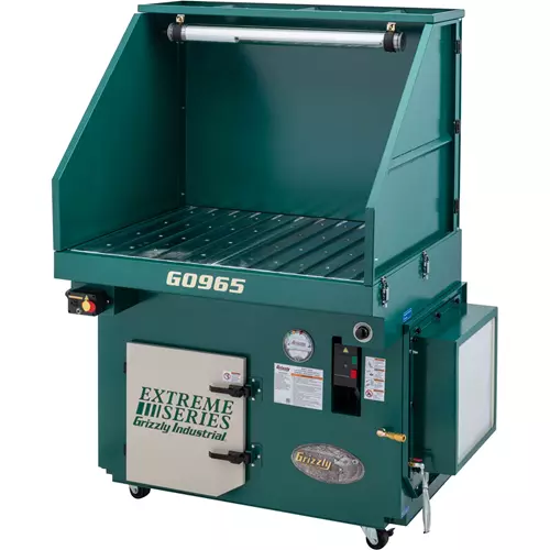

Grizzly G0965 2 HP Heavy Duty Metalworking Downdraft Table
Capture metal dust and particles from grinding, sanding, welding, and cutting, with this HEPA metalworking downdraft table.
This industrial table draws in dirty air through holes in the tabletop, that then passes it through filters to create clean output air.
  • Vacuum pressure gauge indicates when to clean/replace filters
  • Overhead fluorescent work light with safety switch
  • Auxiliary outlet for 120V hand-held tools
  • Industrial quick-coupler connection for pneumatic tools
  • Air pulse button for pneumatically cleaning canister filters
  • Easy-to-clean dust drawer and tray
  • Steel body with two locking casters
This downdraft table will efficiently rid your shop of harmful metal particles thanks to the multiple filtration stages.
First, a spark arrestor aluminum mesh filter catches sparks and stops larger particles from entering the other filters.
Then, two flame-resistant canister filters collect 95% of particles down to 0.2–2 microns in size, extending the life of the HEPA filter.
Finally, a MERV-17 HEPA rated filter collects fine dust particles down to 0.3 microns at 99.99% efficiency.
There is a total surface area of 242 square feet with all the filters combined!
The 2 HP motor provides a high air volume of 1350 CFM, creating the suction needed to capture larger metal particles.
In addition to particle collection, the 5/8" holes of the grated table provide spots to attach jigs and fixtures - perfect for use in welding fabrication. Keeps everything you need within easy reach.
The table allows for a high load capacity of over 1500 pounds!
The G0965 manual was written by our U.S.-based Technical Documentation Department and is packed with useful information. The complete and easy-to-read manual makes it easier to assemble and maintain your machine.
Downdraft table parts may be available online and shipped from the Grizzly parts warehouse in Springfield, MO.
  • Motor: 2 HP, 230V/460V (prewired 230V), 3-phase, 6.6A/3.3A
  • Air suction capacity: 1350 CFM
  • Inlet hole area: 1.6 sq. ft.
  • Outlet size: 20" x 18"
  • Number of filters: 4
  • First-stage filter size: 630 x 285 x 22mm
  • Second-stage filter rating: 0.2–2 Microns @ 95% (x2)
  • Third-stage filter: HEPA filter 0.3 Microns @ 99.99%
  • Table size: 44" W x 35-5/8 D"
  • Floor to table height: 40-1/2"
  • Table load capacity: 1543 lbs.
  • Overall dimensions: 56" W x 39" D x 74" H
  • Approximate shipping weight: 1019 lbs.
