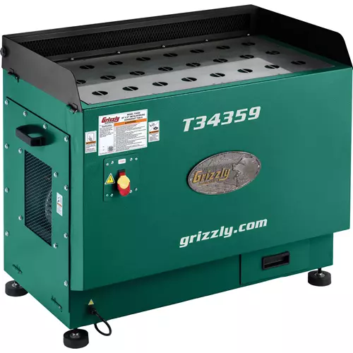

T34359 Metalworking Downdraft Table
Streamline metal dust collection with a high-performance downdraft table.
Tackle metal dust from grinding, sanding, soldering, and polishing with this essential metal shop accessory. The squirrel cage impeller offers 1850 CFM of powerful suction to draw down metal debris through holes in the steel table. Dual filters provide 200-micron filtration to maximize the amount of fine metal pieces that are removed from the air.
This quiet metal dust collector offers a semi-enclosed area so that you can work continually on your metal projects with minimal debris. The easily accessible clea-nout tray collects swarf to keep it off your equipment and shop floor. And with its compact size, it is an ideal choice for small metal shops and hobbyists who want to improve the safety and cleanliness of their work area.
