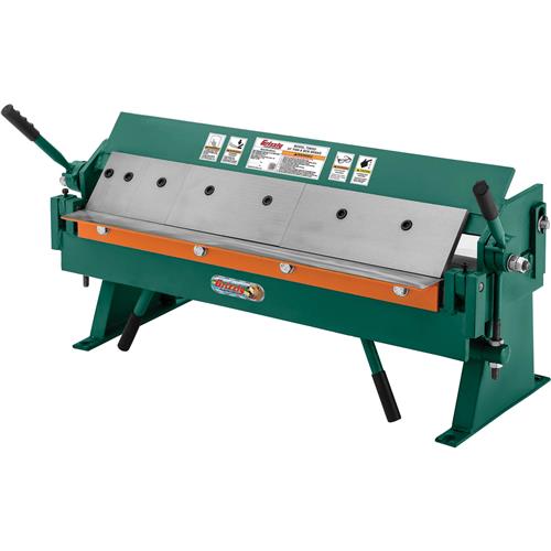

T28522 24" Pan and Box Brake
Take care of your own fabrication needs.
The T28522 24" Pan and Box Brake is indispensable for increasing the strength of sheet metal plates with bends or fabricating more complicated brackets, gussets, boxes, or fixtures.
It can handle setting an angle in 20-gauge mild steel up to 135°.
The T28522 comes with five removable fingers for box forming and other special bending operations. The fingers can be used individually or all at once.
Like all Grizzly pan and box brakes, the T28522 comes with a 1-year warranty which covers parts and assures the unit is free from factory defects.
The T28522 manual was written by our U.S. based Technical Documentation Department and is packed with useful information. The complete and easy-to-read manual makes it easier to assemble and maintain your pan and box brake.
The Grizzly Customer Service and Technical Support Teams are U.S. based. Parts for the pan and box brake may be available online and shipped from the Grizzly parts warehouse in Springfield, MO.
  • Maximum width: 24"
  • Maximum thickness at half width (mild steel): 18-gauge
  • Maximum thickness at full width (mild steel): 20-gauge
  • Brake range: 0-135°
  • Minimum reverse bend: 3/8"
  • Maximum box depth: 2"
  • Number of fingers: 5
  • Finger sizes: 1", 2", 3", 8", 10"
  • Footprint: 26-1/2" x 10-1/2"
  • Overall dimensions: 32" W x 11-1/2" D x 16-1/2" H
  • Approximate shipping weight: 110 lbs.
