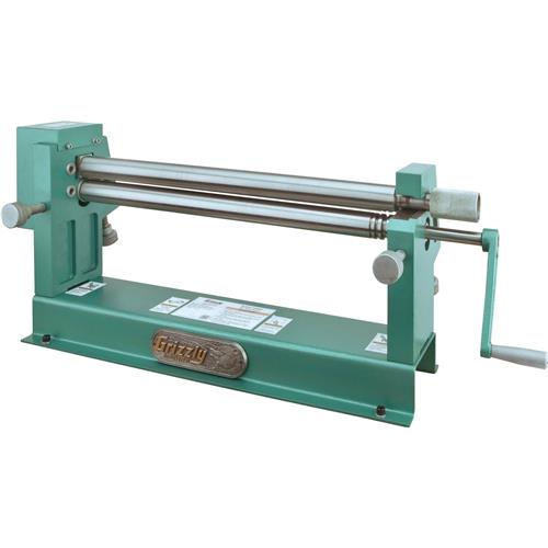

T25688 22-Gauge 24" Slip Roll
Use mechanical advantage to roll mild steel up to 22-gauge.
The T25688 22-Gauge 24" Slip Roll is used to flatten and create constant-radius curves in sheet metal workpieces.
The three-roller system adjusts to allow the operator to complete a number of procedures.
This Slip Roll can quickly adjust to create cone, spiral or continuous cylindrical shapes with sheet metal up to 22-gauge.
The T25688 features a quick-release upper roller designed specifically for the easy release of cylindrical workpieces from the machine.
Workpieces can be bent to job specification, straightened, or even slightly flattened.
In addition to sheet metal, this slip roll has 1/8", 3/16", and 1/4" grooves for precise wire/rod bending.
Like all Grizzly slip rolls, the T25688 comes with a 1-year warranty which covers parts and assures the unit is free from factory defects.
The T25688 manual was written by our U.S. based Technical Documentation Department and is packed with useful information. The complete and easy-to-read manual makes it easier to assemble and maintain your slip roll.
The Grizzly Customer Service and Technical Support Teams are U.S. based. Parts for the slip roll may be available online and shipped from the Grizzly parts warehouse in Springfield, MO.
  • Maximum width: 24"
  • Maximum thickness mild steel: 22-gauge
  • Minimum forming diameter: 1-5/8"
  • Wire sizes: 3/32", 1/8", and 5/32"
  • Footprint: 9-1/2" W x 26" L
  • Overall dimensions: 38" W x 9-1/2" L x 16-1/4" H
  • Approximate shipping weight: 131 lbs.
  • Quick release top roller
  • Easily adjustable rollers
  • Hardened steel gearing
