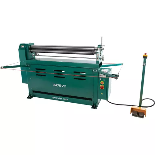

G0971 51" 16-Gauge Powered Slip Roll
The convenience of electric operation for large-capacity sheet metal bending.
The power feed streamlines the process of flattening and creating constant-radius curves in sheet metal workpieces.
Once your material has been inserted into the machine, it is hands-free operation with two rollers providing the necessary force.
This slip roll is easy to run in both forward and reverse, with foot pedal controls that include an emergency stop button.
There is also a safety proximity safety cable that shuts the machine down if you move into it.
Effortlessly bend not only sheet metal but also wire and rods via the 5/16", 3/8", and 1/2" grooves.
Handwheel adjustable rollers simplify the process of modifying the roller height based on your material thickness.
A quick-release top roller is designed specifically for the easy release of cylindrical workpieces from the machine.
Hardened steel gearing and rolls ensure long-life for years of frequent use of this 51" electric slip roll.
  • Motor: 1 HP, 110V, single-phase, 14A
  • Maximum capacity: 51"
  • Gauge: 16-Gauge mild steel
  • Minimum roll size: 3"
  • Rod/wire grooves diameter: 5/16", 3/8", and 1/2"
  • Footprint: 58-1/2" x 20-1/2"
  • Overall size: 86-1/2" W x 37" D x 48" H
  • Approximate shipping weight: 920 lbs.
  • Hands-free operation
  • Forward/reverse foot pedal controls with emergency stop button
  • Proximity safety stop
  • Three roller grooves for rolling wire or rods
  • Handwheel adjustable rollers
  • Quick-release top roller
  • Hardened steel gearing and rollers
  • 1-year limited warranty
