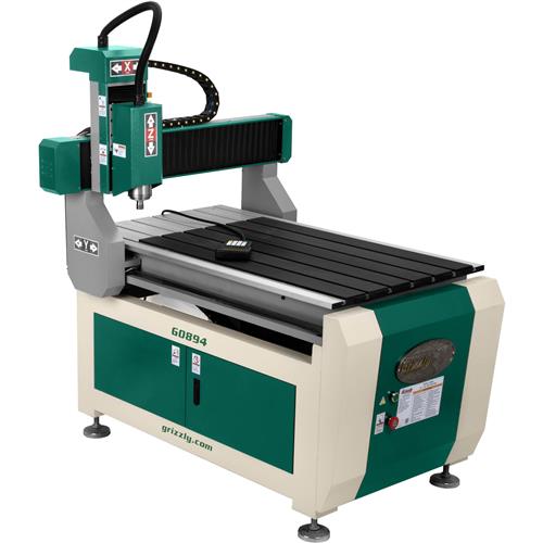

G0894 24" x 36" CNC Router
Redefining small-scale precision production.
The G0894 CNC Router boasts a large 23-5/8" x 35-3/8" cutting area with a 3 HP, 24,000 RPM spindle motor to do the work.
This machine features stepper motor driven ball screws on all axes that can approach cutting speeds of 400 inches per minute. This ensures accurate, repeatable results and saves you precious time in the shop.
The integrated controller allows you to store commonly used programs on the hard drive as well as load programs from a flash drive or even connect directly to you PC.
The spindle utilizes ER20 collets allowing for a wide range of tooling options.
The one-shot oiler for the precision ground bearing carriages and the water cooled spindle prove that this machine is ready for production.
This machine is compatible with many common CAD/CAM platforms including, but not limited to:

  • Required power source: 220V, single-phase, min. 20A circuit
  • Motor: 3 HP, 220V
  • X-, Y-, Z-axis motors: Stepper, 4.3A
  • Cutting area: 23-5/8" x 35-3/8"
  • Cutting accuracy: +/-0.005"
  • Maximum distance spindle to table: 6-1/2"
  • Spindle Speed: 0-24,000 RPM
  • X-axis travel: 35-3/8"
  • Y-axis travel: 23-5/8"
  • Z-axis travel: 5"
  • X-, Y- travel speed: 33 FPM
  • Z- travel speed: 16 FPM
  • Collet Size: 1/8", 1/4", 1/2"
  • Collet Type: ER20
  • Footprint: 47-1/4" x 28-1/2"
  • Overall dimensions: 45" W x 56-1/2" D x 62" H
  • Approximate shipping weight: 882 lbs.
  • Digital display w/USB port and keypad
  • Liquid-cooled spindle
  • Table with T-track
Please note: This item does not include CAD/CAM software, see T28100 or T28101 V-Carve software.
