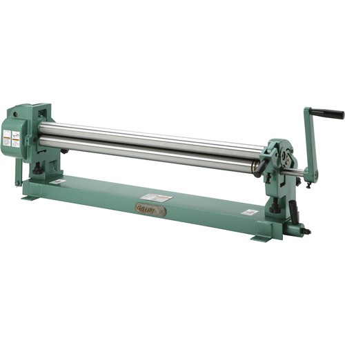

Slip roll up to 36" wide and 22 gauge mild steel with this bench-top sheet metal roller.
The T21318 36" Slip Roll is a sheet-metal working machine used to create constant-radius curves in workpieces.
The three roller system allows the operator to create cylinders, cones, and bends.
The T21318 features a quick-release system for releasing cylindrical workpieces from the machine.
Cast-iron construction and 2" diameter ground and polished rolls make this slip roll ideal for many fabricating uses.
With a net weight of 200 pounds and features like heavy bearings and gearing and the ability to slip roll 3/16"–5/16" diameter rod/wire stock, every sheet metal shop needs one of these!
Like all Grizzly slip rolls, the T21318 comes with a 1-year warranty which covers parts and assures the unit is free from factory defects.
The T21318 manual was written by our U.S. based Technical Documentation Department and is packed with useful information. The complete and easy-to-read manual makes it easier to assemble and maintain your slip roll.
The Grizzly Customer Service and Technical Support Teams are U.S. based. Parts for the slip roll may be available online and shipped from the Grizzly parts warehouse in Springfield, MO.
  • Maximum capacity: 36"
  • Minimum forming diameter: 2"
  • Footprint: 42" x 10-1/2"
  • Maximum thickness: 22-Gauge mild steel
  • Rod/wire grooves diameter: 3/16", 1/4", 5/16"
  • Overall dimensions: 49" W x 17" D x 15" H
  • Approximate shipping weight: 274 lbs.
  • Precision-ground cast-iron rollers
  • 36" wide capacity
  • Quick-release top roller
  • Hardened steel gearing
