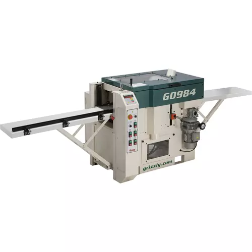

G0984 4-Sided Planer/Moulder
Easily create your own surfaced-on-four-sides (S4S) lumber and custom moulding.
With this adaptable planer/moulder, four cutterheads powered by separate 4 HP motors simultaneously shape the top, bottom, and sides of your workpieces to ensure surface consistency and quality.
Table height is digitally controlled for quick and repeatable results, and the variable-speed lets you run each board through at just the right pace.
For longer boards, the extension tables and adjustable outfeed fence of this 4-sided planer-moulder offer essential support.
Each cutterhead of this powerhouse includes two HSS single-sided straight knives, and the upper and lower cutterheads include two planing knives.
This combination planer/moulder also includes a one-shot oiler and four dust ports to further boost your efficiency. Take advantage of this machine's multiple benefits to produce S4S lumber, crown moulding, tongue-and-groove, and other decorative profiles in less time. Moulding knives can only be used in the upper cutterhead if you purchase T34390 Cutterhead Moulding Gibs.
FEATURES & BENEFITS:
  • Independently Powered Cutterheads: Each cutterhead features a 4 HP motor that powers through the shaping process for effective stock removal.
  • Digitally Controlled Table Height w/DRO: Allows you to key in exact table height settings, ideal for repeat production work. Features a manual override for easily switching to manual controls.
  • Variable-Speed Feed: Dial in the perfect speed between 7 and 47 FPM as appropriate to the wood type.
  • Centralized Control Panel: Allows convenient, user-friendly access to all motor power controls.
  • Extension Tables: Steel infeed and outfeed extension tables provide sturdy support for longer material.
  • Adjustable Outfeed Fence: Ensures straight board outfeed; ideal for handling shorter lengths.
  • Straight Knives: Includes a minimum of 2 straight knives for each cutterhead for rapid 4-sided surface planing.
  • Built-In One-Shot Table Oiler: Delivers 3 cc of oil per shot to the table for essential lubrication.
  • Four 4" Dust Ports: Maximize dust collection efficiency to prevent excessive wood debris buildup.
  • Cutterhead motors (4): 4 HP, 3-phase, 230V, 11A
  • Feed motor: 1 HP, 3-phase, 230V, 3.4A
  • Table elevation motor: 1/8 HP, 3-phase, 230V, 0.17A
  • Cutterhead speed: 6650 RPM
  • Cuts per minute: 13,300 (per cutterhead)
  • Cuts per inch: 158 – 24 (per cutterhead)
  • Planing feed rate: 7 - 47 FPM
  • Moulding feed rate: 7 FPM
  • Max. cut width: 10-1/4"
  • Max. cut height: 8-1/4"
  • Type and number of knives (upper and lower): Straight knife, HSS, single-sided, 2
  • Type and number of knives (left and right): Straight knife, HSS, single-sided, 2
  • Min. stock length: 12"
  • Min. stock thickness: 3/8"
  • Dust port (4): 4"
  • Footprint: 43-1/2" x 25-1/2"
  • Overall size: 40-1/2" W x 127-1/2" D x 45-1/2" H
  • Approximate shipping weight: 1300 lbs.
Slash your planing and moulding production timelines with the versatile G0984 4-Sided Planer/Moulder.
