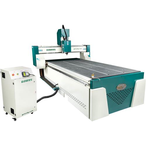

G0895 4' x 8' CNC Router
Unleash the full potential of your shop by adding this CNC.
The full-sized G0895 4' x 8' CNC router has the capacity to fit a full 4' x 8' sheet of plywood and has ample spindle clearance for those thicker workpieces such as live edge slabs.
The massive work area features a 6-zone vacuum table with a 10 HP pump to secure workpieces.
Between the 6 HP, 18,000 RPM spindle, and the AC servo-controlled X- and Y- axes that approach rapid speeds of 1,600 inches per minute, this router is ready to quickly remove material.
The ER32 collet system allows for a wide array of tooling options and the included tool setter makes it simple to set them up.
An air-cooled spindle and automatic oiler system mean no extra hassle with cooling systems or maintenance schedules.
The integrated, hand-held controller allows you to store programs to its hard drive or load programs from a flash drive. It can even connect directly to you PC for file transfer and/or controller software updates.
This machine is compatible with many common CAD/CAM platforms including, but not limited to:
  • Vcarve and Vcarve Pro
  • Aspire
  • Cut2D
  • Fusion360
  • Solidworks
  • Type3
  • Artcam
  • UG
  • Pro/E
  • MasterCAM
  • Cimatron
  • Ucancam
If you are wanting a more in-depth overview of the design software used with the G0895, watch a three-part series on how to get started with CNC.
  • Required power source: 220V, 3-phase, min. 30A circuit
  • Spindle motor: 6 HP, 220V
  • X-, Y- and Z-axis motors: AC Servo, 7.1A
  • Cutting area: 51" x 98-1/2"
  • Z-axis travel: 11"
  • X- and Y- travel Speed: 1500 IPM
  • Z- travel speed: 400 IPM
  • Spindle speed: 6000-18000 RPM
  • Collet Size: 1/4", 1/2"
  • Collet Type: ER32
  • Footprint: 122-1/2" L x 56-1/2" W
  • Overall dimensions: 85" W x 124" D x 72" H
  • Approximate shipping weight: 2535 lbs.
  • Yaskawa 850W Servo Motor
  • Taiwan HIWIN linear guide
  • German WHM rack
  • 10 HP Vacuum Pump
  • 6-Zone vacuum table
Please note: This item does not include CAD/CAM software, Grizzly offers software from Vectric.
Need help? We offer U.S.-based customer service and technical support to get your questions answered and help keep your equipment running in top condition. And to ensure your satisfaction, the G0895 comes with a 1-year warranty.
