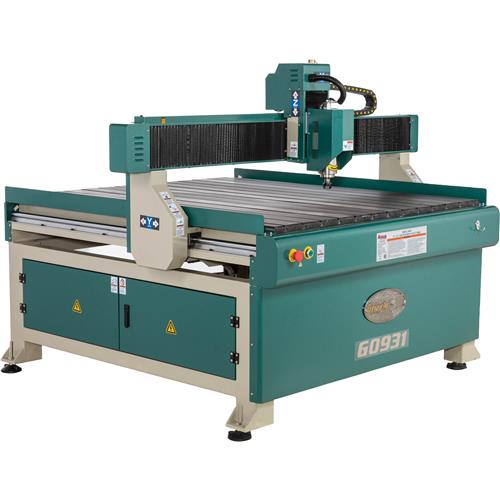

G0931 47" x 47" CNC Router With T-Slot Table
A CNC router with production-level cutting capability for your small shop.
The G0931 CNC Router With T-Slot Table is ready to cut a wide range of parts from basic shapes up to highly detailed 3D geometry using wood, plastics, and other non-metallic materials.
It comes equipped with a rigid steel frame and a 47-1/4" x 47-1/4" x 6-1/4" cutting area.
Extruded aluminum T-slots provide virtually unlimited clamping configuration, and a water-cooled 24,000 rpm spindle allows for heavy-duty machining.
The welded-steel gantry and ball-screw driven linear guides on all 3 axes contribute to this router’s top-notch precision.
The included ER20 collets ensure the use of a broad selection of tooling options, while the tool touch-off pad allows you to quickly set the Z-height.
This machine is compatible with many common CAD/CAM platforms including, but not limited to:
  • Vcarve and Vcarve Pro
  • Aspire
  • Cut2D
  • Fusion360
  • Solidworks
  • Type3
  • Artcam
  • UG
  • Pro/E
  • MasterCAM
  • Cimatron
  • Ucancam
Store your frequently used programs on the handheld controller or run them directly from a thumb drive. A PCI interface also allows you to connect directly to your PC.
  • Required power source: 220V, single-phase, min. 20A circuit
  • Spindle motor: 3HP, 220V
  • X-, Y-, Z-axis motors: hybrid stepper, 4.0A
  • Collet type: ER20
  • Collet sizes: 1/8", 1/2", 4mm, 6mm
  • Cutting area: 47-1/4" X- x 47-1/4" Y- x 7-7/8" Z-
  • Cutting accuracy: +/-0.005"
  • Spindle speed: 6,000 – 24,000 RPM
  • X- & Y- travel speeds: 59 FPM
  • Z- travel speeds: 33 FPM
  • Overall dimensions: 70" W x 62-1/2" D x 53- 1/2" H
  • Approximate shipping weight: 948
  • RichAuto DSP A11 handheld controller with USB port and keypad
  • Aluminum table with T-slots and PVC padding
  • Tool touch-off pad for quickly setting Z-axis height
  • 80W submersible water pump for spindle cooling
  • Water-cooled spindle with included water pump
