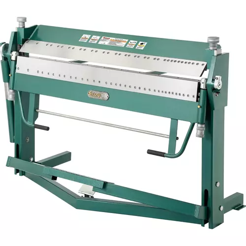

T28325 59" Pan and Box Brake
Expand your fabrication capabilities and achieve precise and repeatable metal bends.
Boasting a 59-inch bending capacity and a diverse range of finger sizes, the T28325 Pan and Box Brake delivers exceptional versatility.
Removable upper and lower fingers enable precision box bends, along with transverse and down-flanged shapes, expanding your fabrication potential.
From 1-inch box flanges to full-width pans, this brake offers the necessary capacity and flexibility for accurate results.
The integrated work stop, featuring a 135-degree scale, guarantees repeatable production, while precision-ground steel clamping fingers create a 5/8-inch minimum reverse bend.
The T28325 manual was written by our U.S.-based Technical Documentation Department and is packed with useful information.
  • Maximum working width: 59"
  • Maximum thickness at half width (mild steel): 16-gauge
  • Maximum thickness at full width (mild steel): 18-gauge
  • Brake range: 0–135°
  • Minimum reverse bend: 5/8"
  • Maximum pan depth: 2"
  • Fingers: (2) 1-1/2", (4) 2", (5) 3", (6) 4", (1) 9"
  • Footprint: 65" x 31"
  • Overall dimensions: 71-1/2"L x 40-1/2"W x 46"H
  • Approximate shipping weight: 1080 lbs.
  • Pressure adjustment knobs
  • Foot pedal controls clamping fingers
  • Work stop collar for repetitive bends
  • Removable fingers for box bends
We offer U.S.-based customer service and technical support to get your questions answered and help keep your equipment running in top condition. And to ensure your satisfaction, the T28325 comes with a 1-year warranty.
