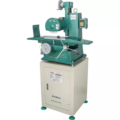

G5963 6" x 12" Surface Grinder with Stand
Precision grinding perfect for the small toolroom and metalworking enthusiast.
The G5963 6" x 12" Surface Grinder allows you to resurface metallic workpieces to create high-tolerance flat surfaces.
Grinding operations are utilized by a table that moves left-to-right and front-to-back while the grinding wheel has up-and-down movement.
By mounting a workpiece to the table, then moving the table and the grinding wheel during the grinding process, extremely small amounts of material can be removed.
The G5963 is equipped with easy-to-reach front mounted handwheels for controlling table and head movement.
The cast-iron table travels in the longitudinal direction driven by a rack-and-pinion mechanism.
The stand doubles as a storage cabinet where you can keep the necessary tools and extra grinding wheels right where you need them.
The included diamond dresser is used to true the grinding wheel, ensuring high-precision results.
Like all Grizzly surface grinders, the G5963 comes with a 1-year warranty which covers parts and assures the unit is free from factory defects. (Consumables are not covered by the warranty.)
The G5963 manual was written by our U.S.-based Technical Documentation Department and is packed with useful information. The complete and easy to read manual makes it easier to assemble and maintain your surface grinder.
The Grizzly Customer Service and Technical Support Teams are also U.S.-based. Parts and accessories for the surface grinder are available on-line and shipped from the Grizzly parts warehouse in Springfield, MO.
  • Motor: 3/4 HP, 115/230V (prewired 115V), single-phase, 7.4A/3.7A
  • Table surface: 6" x 12"
  • Longitudinal travel: 13-1/4"
  • Cross travel: 7-1/8"
  • Maximum distance table to wheel: 8-7/8"
  • Column dial: 0.001" Res/Rev 0.05"
  • Cross dial: 0.001" Res/Rev 0.1"
  • T-slot: 1/2" W x 3/4" H x 15-1/2" L, 7/8" head
  • Grinding wheel: 7" D x 1/2" W
  • Spindle diameter: 1-1/4"
  • Spindle speed: 3450 RPM
  • Footprint: 20" x 20"
  • Overall dimensions: 36-1/2" W x 33" D x 64" H
  • Approximate shipping weight: 591 lbs.
  • 3-Axis handwheel control
  • One-shot lubrication
  • Column dial
  • Cross feed dial
  • Super slide table
  • T-slots for securing a magnetic chuck
  • Heavy gauge sheet metal cabinet
  • Swarf guard
  • Diamond wheel dresser with holder
  • Tool box
  • Wheel balancing kit
